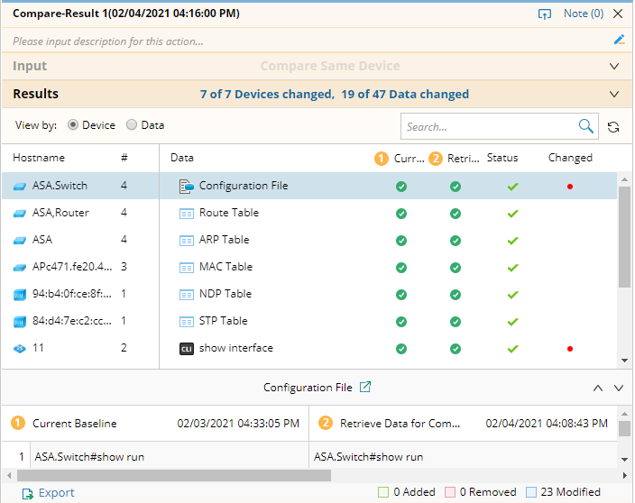

  3. After the comparison is finished, select a device and a changed data type to view the detailed changes. See Comparison Results for more reference.
    Information Tip: The displayed comparison results can be exported to HTML files. To export the comparison result of a single data type, click the  icon and select Export. To export the whole result, click the  icon of the result entry under the Compare node and select Export Result.
    Information Tip: You can also click the hyperlink in the Results area to view the result summary.
