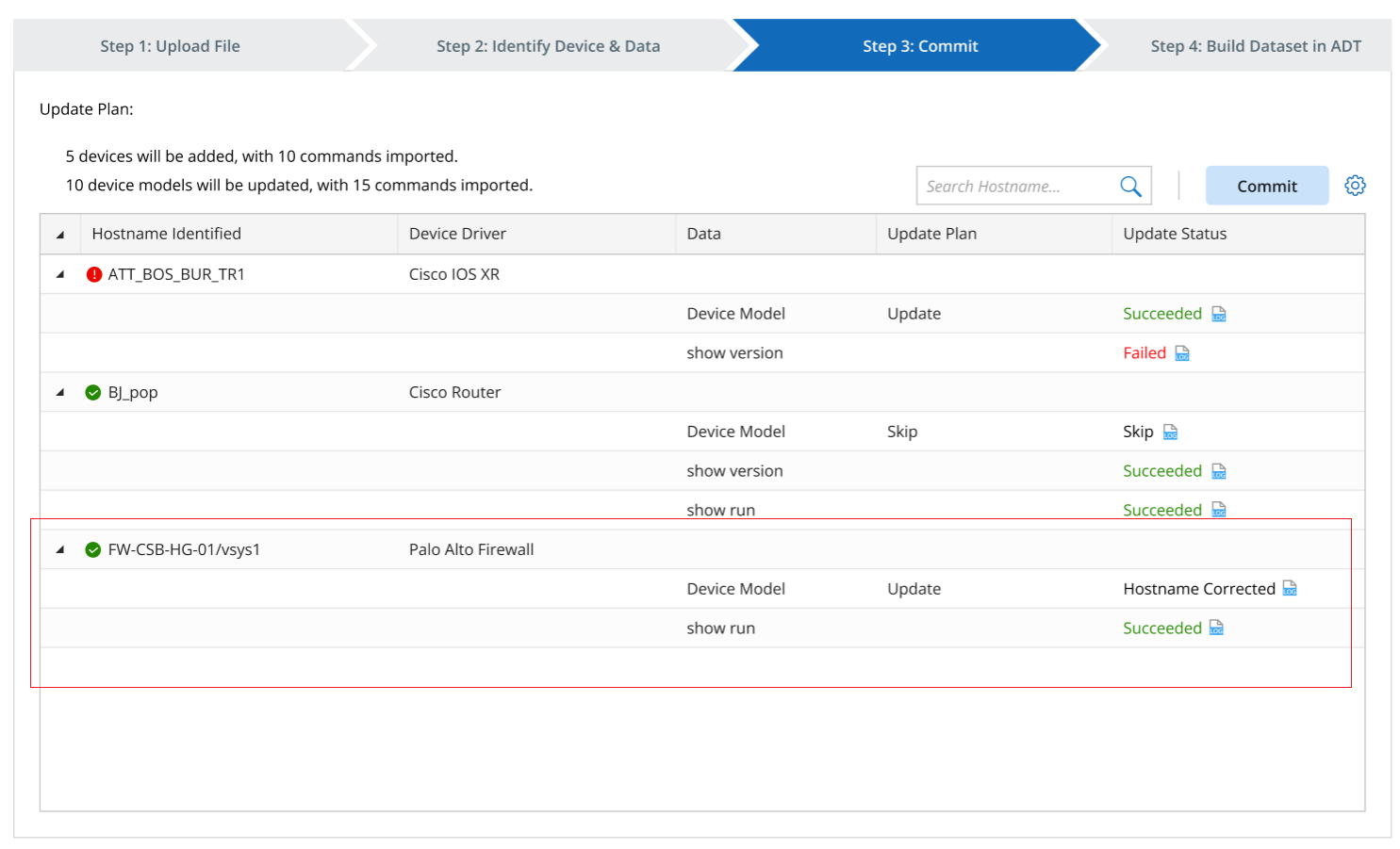

  1. Click Commit.
  2. The output is displayed. You can directly view whether the device is updated successfully via the status and log of each device.
    Note: After clicking Commit, you will be asked if you want to save the corrected hostnames to a table when the detected hostname does not match the parsed one by driver , which can be opened from Hostname Correction Settings. You can view the detected hostnames and their corrected hostnames.
    NoteIf the detected hostname is not the one parsed by the driver, the hostname parsed by the driver will be used, and the status of such hostname will be displayed as “Hostname Corrected”.

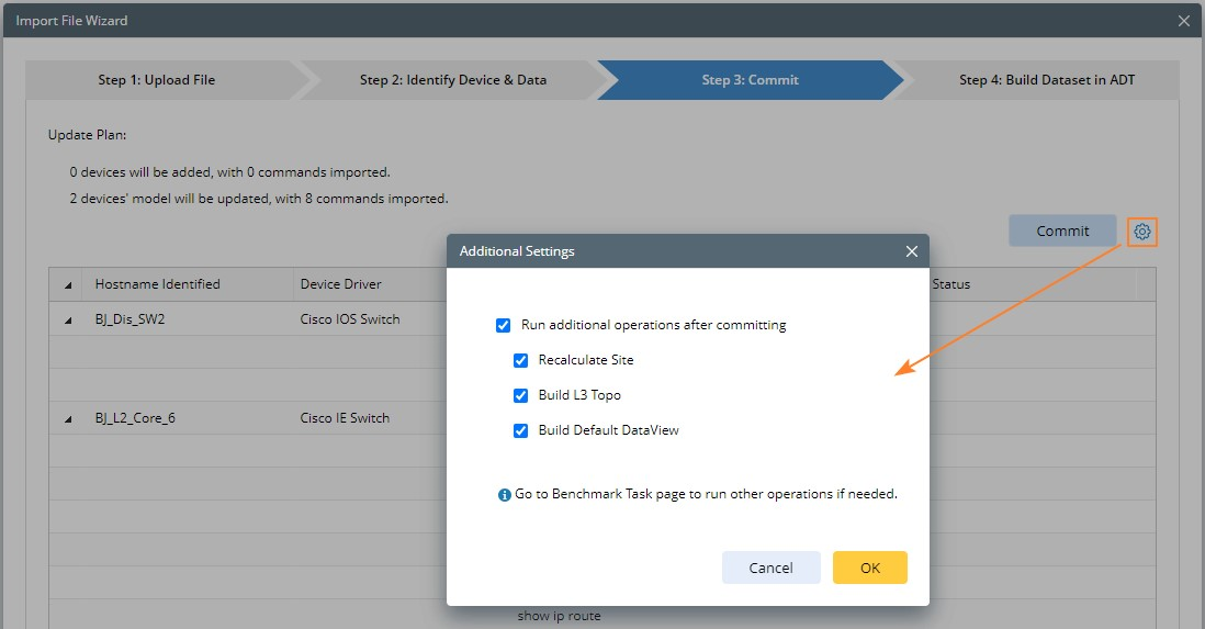

  3. You can click the setting icon to select the additional operations to be performed after the files are committed to the current domain and parsed to build the device model.
