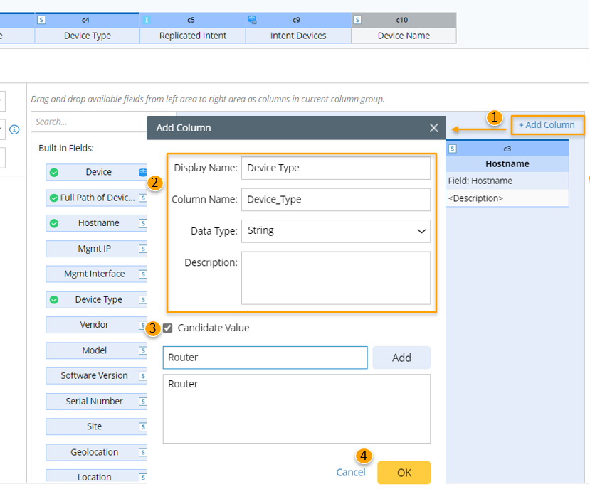

Manually add table column from Automation Data Table Builder.
- Open the Automation Data Table Builder of the target ADT, then click + New Column from the Select Column drop-down list.
- In the pop-up dialog, defining the following to add the new column.
- Display Name: Input the display name for the column.
- Column Name: Column name is the same as display name. However, in column name underscores are used to replace space.
- Data Type: Select one data type from the drop list for the column.
- In the Candidate Value field, input a value which will be a selectable value when you edit a cell in this column.
- Click OK to add the table column.
Note: The data in the Column Name field can be referenced as the value for the macro variable. |

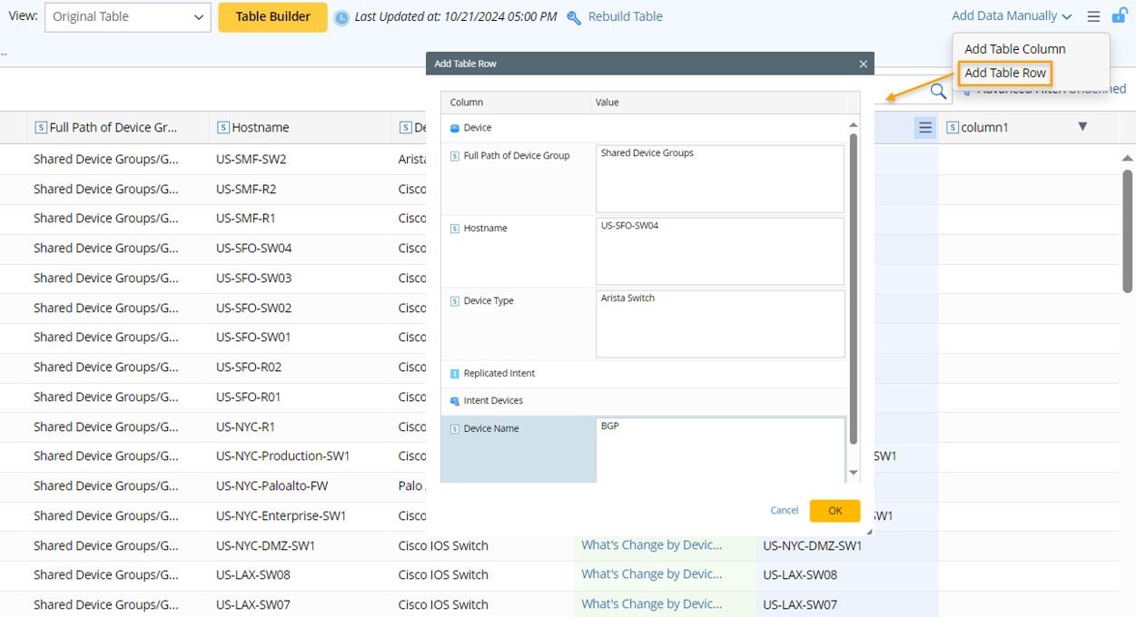

Manually Add Table Row
You can manually add a new row to ADT, then define values for each column of this row. The manually added rows are displayed at the top of the ADT.
- Select the target ADT from the ADT Manger, then go to Add Data Manually > Add Table Row.
- In the pop-up dialog, all the columns are listed for defining the row data for each column.
- Click
of a column (for example, the Intent Column), then set row data for the column.
- Click OK after defining row data for this column.
- Repeat step 2 to add row data for other columns.
- Click
- Click OK in the Add Table Row dialog to finish manually adding table row data.
Note: The manually added rows will not be automatically updated. However, these rows can be manually edited or deleted. |
