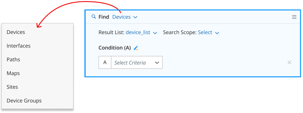

  • Find object in Domain
    You can use a diagnosis logic to find various types of objects in the domain. The found objects that meet the conditions will be placed in a specified result list.
    1. You can select one of the following 6 object types, and the ‘Find’ UI will change depending on the selected object type.
      图形用户界面, 应用程序
描述已自动生成

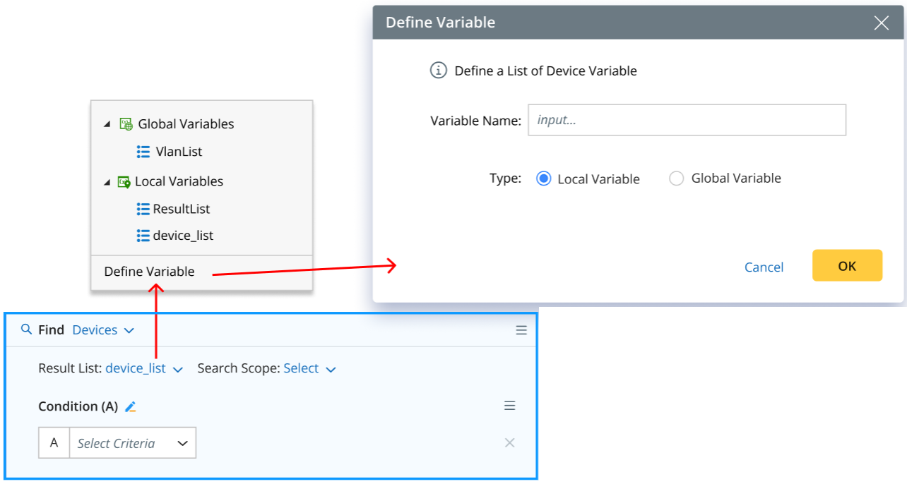

    2. For ‘Result List’, you can directly select a list variable in global variables or local variables, whose variable type should be consistent with the selected object.
      You can also define a new list variable by clicking Define Variable. The variable type is fixed, and you only need to enter the list variable name and specify whether it is a local variable or a global variable.
      图形用户界面, 应用程序
描述已自动生成
    After the above definition, all matching objects found according to the specified scope and condition will be put into a specified result list variable. If no condition is defined, all objects in the scope will be added to the list.

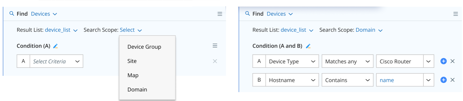

    • Find Devices in Domain: You can find devices from a device group, site, map, or domain, and then define the criteria to narrow down the scope.

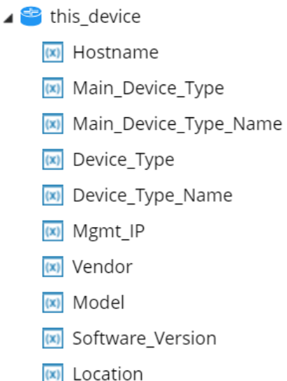

      $this_device can be used as a special device object so users can use the device property variable directly.

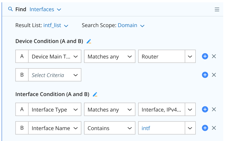

    • Find Interfaces in Domain: You can find interfaces from a device group, map, or domain, then define the criteria related to the device and interface to narrow down the scope.

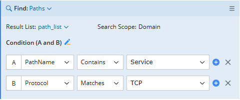

    • Find Paths in Domain: The search scope is domain by default. You can search path from all application paths in a domain.

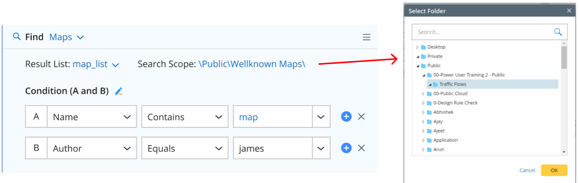

    • Find Maps in Folder: You just need to select a map folder as the search scope, then define the criteria to narrow down the scope.

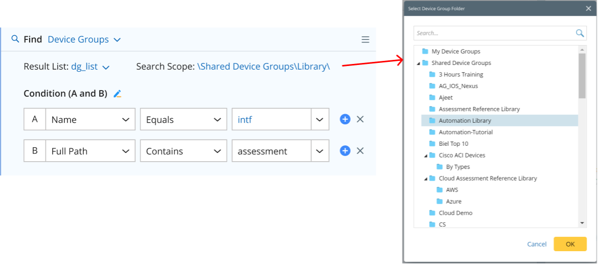

    • Find Device Groups in Folder: You just need to select a device group folder as the search scope, then define the criteria to narrow down the scope.

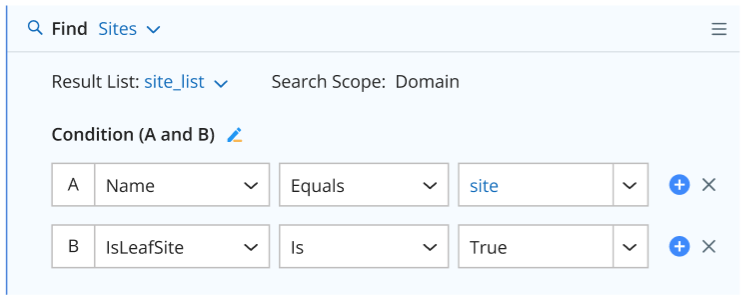

    • Find Sites in Domain: There is no need to specify the search scope, and the sites will be searched in all container/leaf sites of the current domain.
