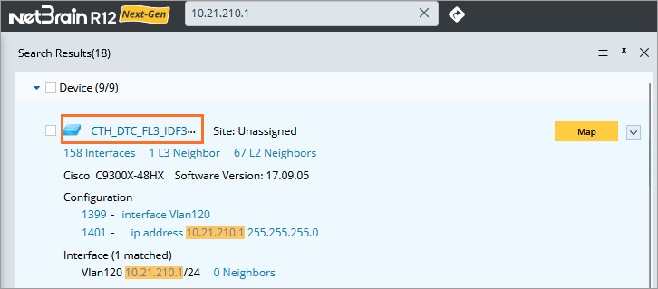

  1. Enter an IP address in the search bar, and then press Enter
    The search results are displayed with the matched keyword highlighted.

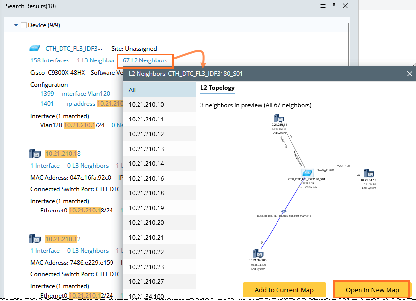

  2. Click the <number> L3 Neighbors hyperlink (for example, 1 L3 Neighbors). A preview map containing the searched device and its neighbors is displayed.
  3. To display the preview map on the map that is already open, click Add to Current Map.
  4. To display the preview map on a new map, click Open in New Map.

View device details in a dashboard
  • Click the device name in the search result.
    A Device Details dashboard matching its device type opens, showing the detailed information about the device. See Semantic Search for further operations.

  1. Click the <number> L2 Neighbors hyperlink (for example, 62 L2 Neighbors) to open the corresponding neighbor list as well as the preview map of the neighbor topology.
  2. To open the preview map, click Open in New Map.

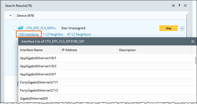

Search for Device Interface
  1. Click the <number> Interfaces hyperlink (for example, 158Interfaces) to open the interface list of the device.
  2. Click the IP address of the target interface. The system automatically starts a new search using the IP address as the keyword.
