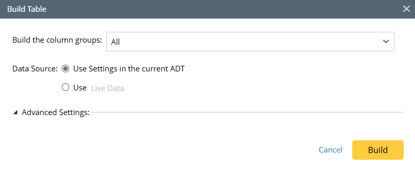

  4. Click Save to save the settings of this column group, but the ADT data will not be built.
  5. Click Save and Build to save the settings and build the column group data.
    Information Tip: If you click Save, the system will save the settings without building the column group data, and the Automation Data Table Builder will remain open.
  5. Click Save and Build to save the settings and build ADT data.
    Information Note: The two Data Source option determines the data source used for building ADT data. Default Data Source for Automation at domain level is configured in Domain Management (Advanced Settings). When enabled, it can have essential impact on the data source settings in applicable functions (for more information, see Apply Default Data Source to AutomationSpecify Data Source for Building ADT Columns).
