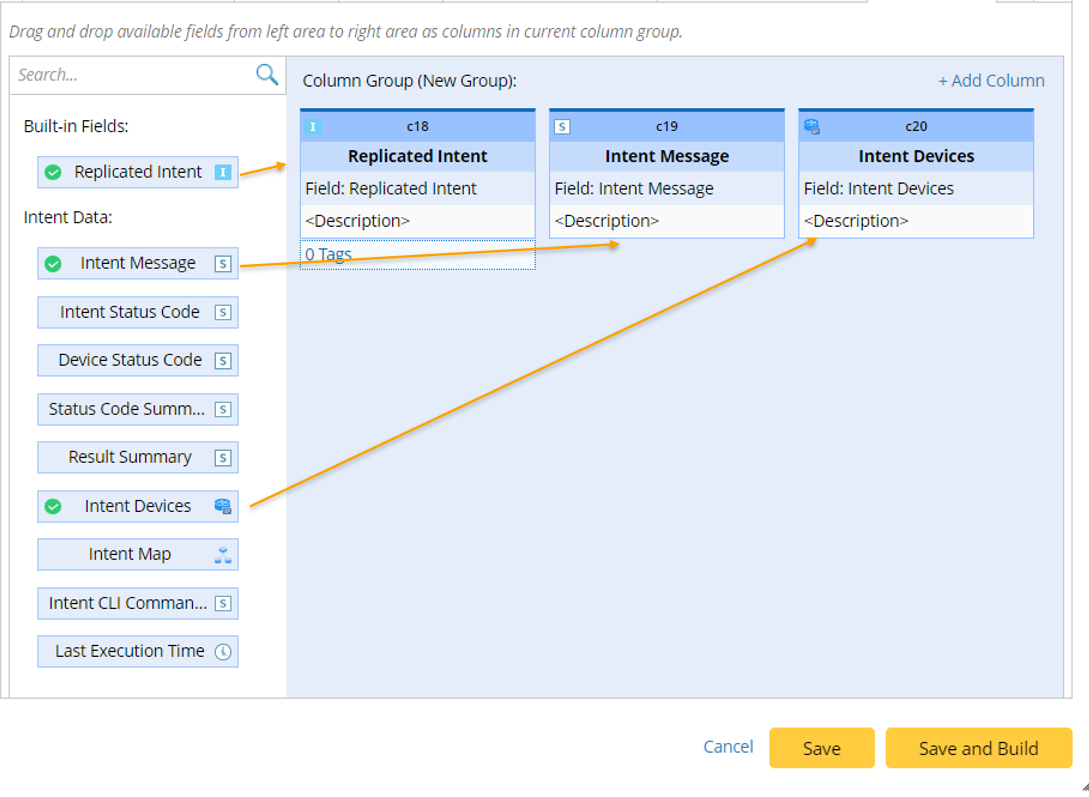

  3. Mapping available fields to Column Group: In the right pane, drag and drop the available fields to the column group definition area to create ADT columns automatically.
    There are two categories of data fields in this area to be selected:
    Built-in Fields: The built-in field available for this group table is the Replicated Intent field.
    Intent Data: Other intent information can be displayed in the intent output columns of the ADT, including Intent Message, Intent Status Code, Device Status Code, Status Code Summary, Result Summary, Intent Devices, Intent Map, Intent CLI Commands, and Last Execution Time.

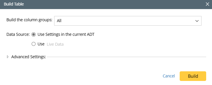

  4. Click Save to save the settings. The table builder will remain open and table data is not built.
  5. Alternatively, you can click Save and Build to save the settings and build the ADT.
