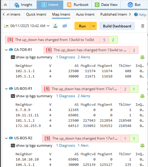

Run and View Results
After running the Map Intent, the intent details and execution results will be displayed.
  • Run Map Intent directly on the current interface, and they can run more than once.
  • The status codes at the NI and device levels will be displayed directly. And clicking the alert hyperlink can view more details.
  • The number of diagnoses and alerts can be displayed in each command section.

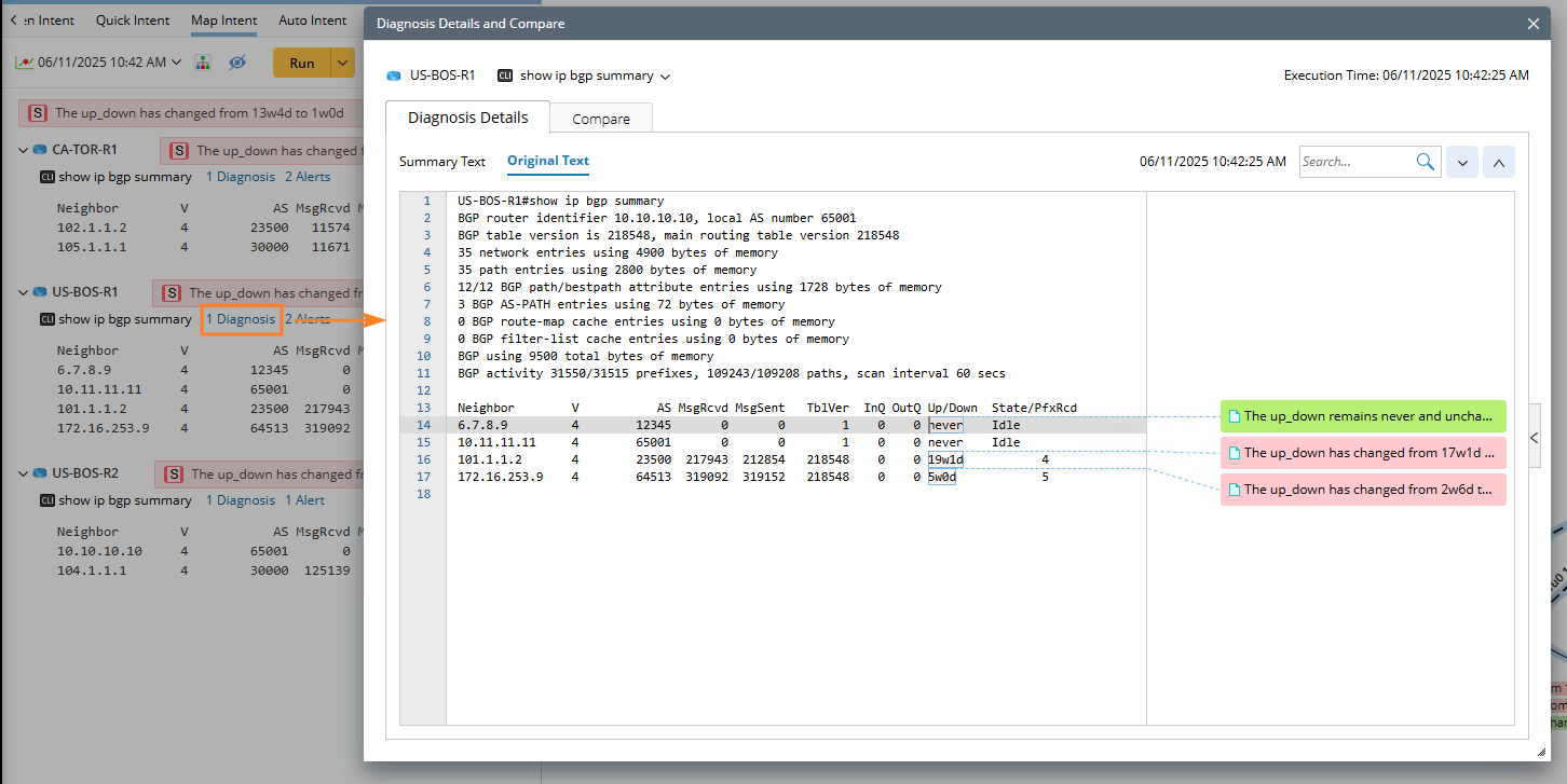

View Diagnosis Details
Clicking the Command section or Diagnosis link can open the Diagnosis Details and Compare pane, which is located in the Diagnosis Details tab by default.
  • All the diagnosis notes of the current command will be shown in the middle part of the pane.
  • Clicking a diagnosis note can view its details on the right of the pane.
View Comparison Result
You can click the Compare icon to open the Diagnosis Details and Compare dialog, and it is located in Compare tab by default. Here you can view the differences between the CLI command output in this execution result and the Baseline value of this command in NI.
Information NoteIf you want to filter the comparison results, select the required checkbox in the lower-right corner of the tab.
