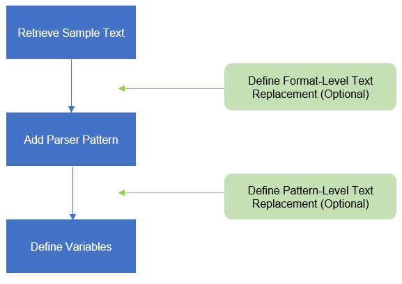

Text replacement is a flexible method to automate text preprocessing before parsing. When you want to search and replace any string in the raw text, you can define a text replacement.
Text replacement is defined at two levels:
- Format level: search and replace a string in the whole range of sample text in one format.
- Pattern level: You can define multiple patterns in a single format. Text replacement can be defined for an individual pattern. The system searches for and replace text within the specified range that matches the parser definition of that pattern.

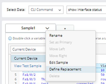

- Format-level replacement: Click Define Replacement from the Format drop-down menu. In the pop-up window, specify the search and replacement rules.
- Pattern-level replacement: Click Define Replacement from the Pattern drop-down menu. In the pop-up window, specify the search and replacement rules.

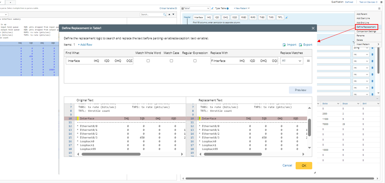

- Form a Table Header Line
When a device command output looks similar to a standard table format but only misses a table header line, you can define text replacement to replace the line of text ahead of the table data with a customized table header line. This twist allows you to continue to define a Table Parser to parse the table data. - Fill Up Table Headers
When one or more table headers are missing in the sample text, using a Table Parser directly will lose the data of those columns. - Rename Duplicate Table Header
When two table headers have the same name, the latter header cannot be parsed.
To resolve this issue, ensure that each table header has a unique name. You can do this by replacing the line containing the duplicate headers with a new line that uses distinct header names. - Adjust table column width

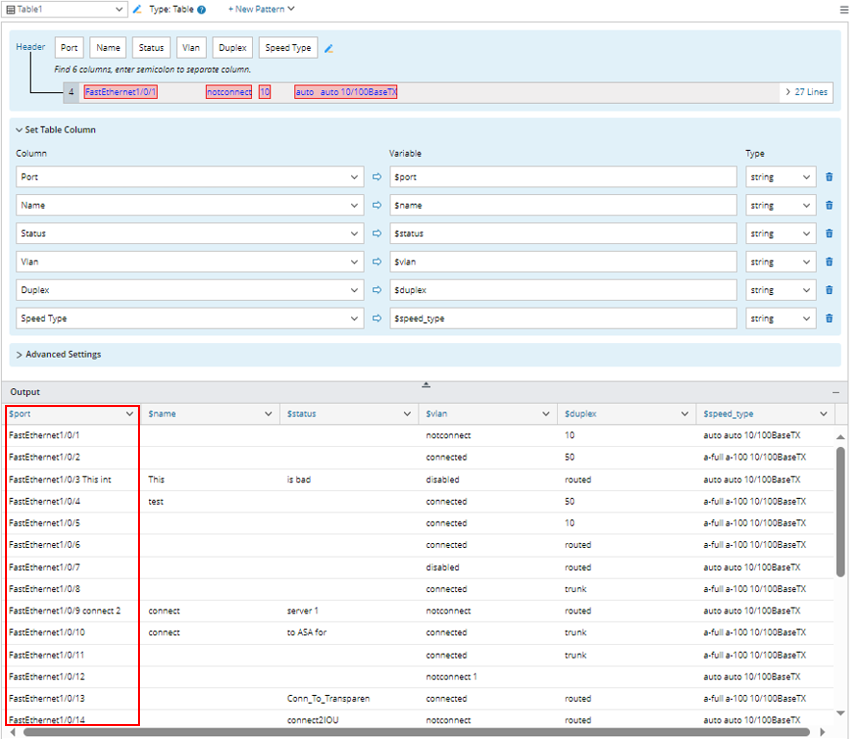

- Retrieve command data show interface status on the device BJ_L2_Core_3, then select several lines from the sample text to parser the table. The interface name is short name in the parsed results.
- Click Define Replacement from the Format menu.

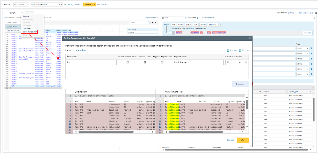

- In the pop-up window, define the settings to change the short name (Fa) to long name (FastEthernet).
- Click +Add Row, then set to replace Fa with FastEthernet. The options are described below:
- Find What - the text you are searching for in the given range.
- Match Whole Word - once enabled, searches will only match if the result is a whole word, e.g., a search for “FastEthernet” will not return “FastEthernet1/2”.
- Match Case - once enabled, search terms are case-sensitive, e.g., a search for “ethernet” will not return “Ethernet”.
- Regular Expression - once enabled, search terms will use the regular expression engine to find complex patterns in the text; otherwise, search terms will be interpreted literally.
- Replace With - the text that will replace what is matched.
- Replace All Matches - replace all matches in the text scope.
- Replace First Only - replace the first match only.
- Click Preview, you can preview the changes in the lower part of this window.

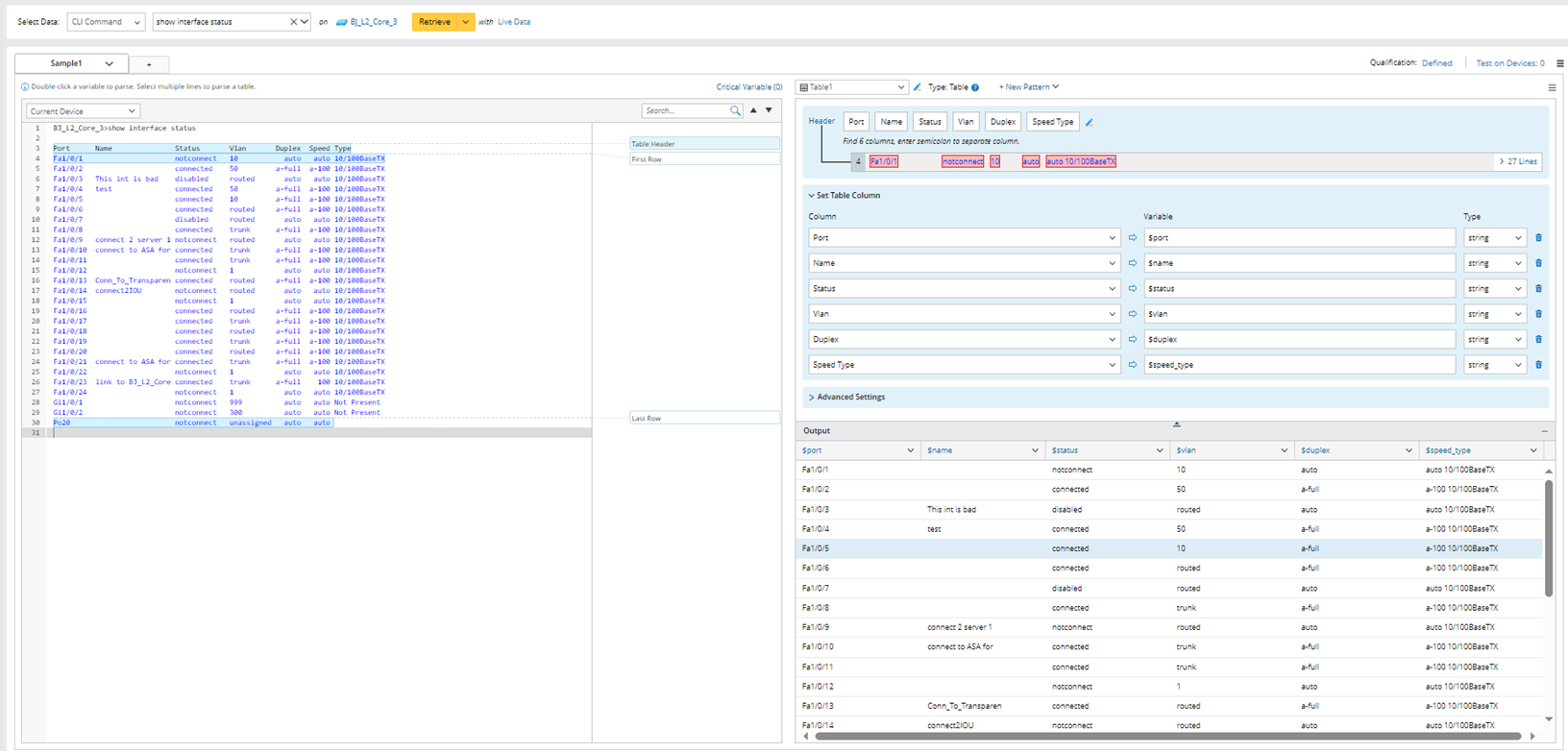

- Click OK to close this window, then you can see the changed results in the output area.
