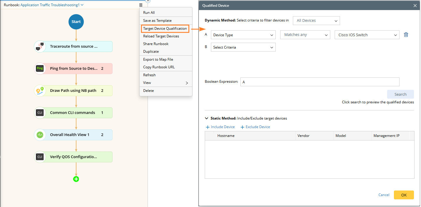

Click the
icon and select Target Device Qualification to refine devices for the Runbook.
You can use the following options to refine the target devices. When no device qualifications are defined, all devices on the current map will be loaded as target devices by default.
To narrow down the default devices from the input map, use the Dynamic Method to set criteria to filter target devices.
Note: To add more devices beyond the narrowed scope, use the static method combined with the dynamic one. - To not use these default devices, you can check the Ignore devices on the map check box and only use the static method to manually add devices as input.
- Click OK.

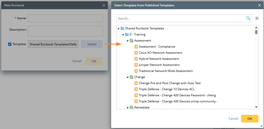

When you create a runbook on a map by applying a runbook template:

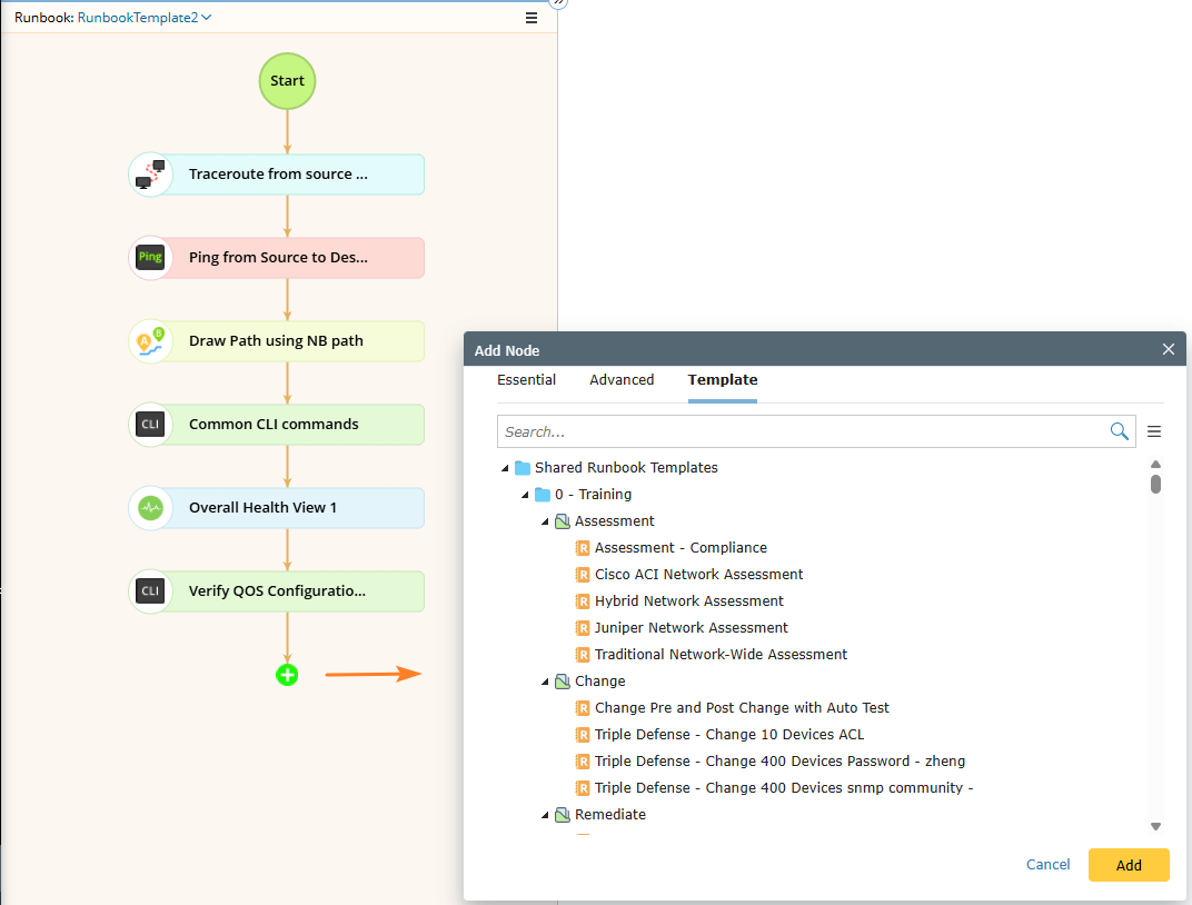

When you add the runbook template in the Runbook:

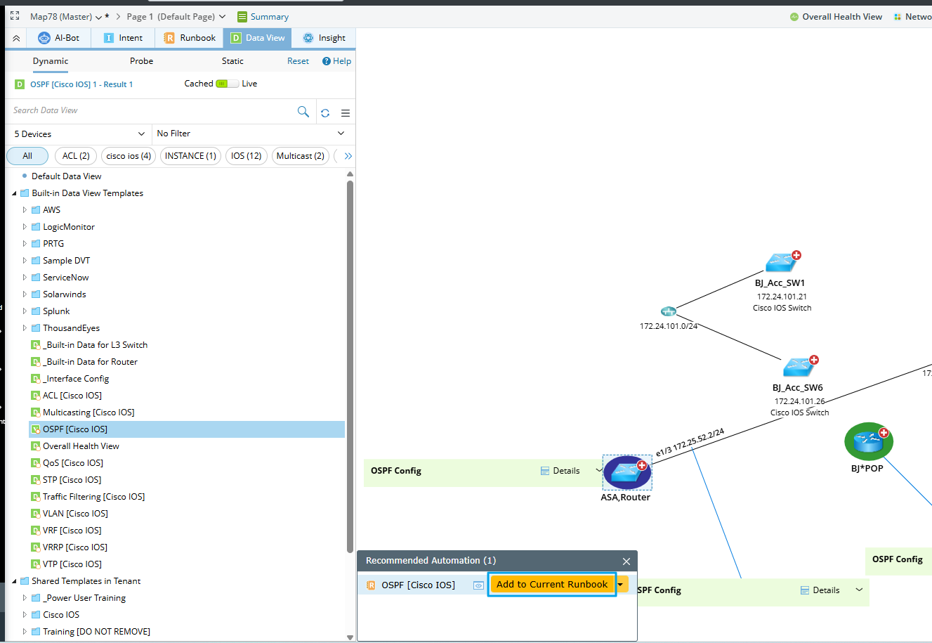

Add a runbook template to a runbook in the recommended automation with the data view template, decision tree, and network intent:
