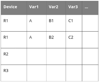

Common ADT Structure Scenario:
In intent-based network assessments, a common table pattern emerges where a single device (e.g., Device "R1") may have multiple rows in the ADT, each with different parameters.
To build such an ADT, a Network Intent Configuration (NIC) using signature variables is typically required. However, this approach can be complex to maintain and reuse.
