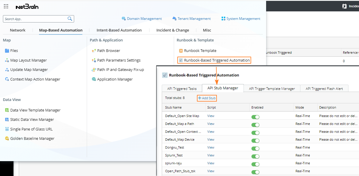

The first step to create a runbook-triggered automation is to create an API Stub in NetBrain.
Steps Required from NetBrain End
- Navigate to Runbook-Based Triggered Automation > API Stub Manager tab. Click Add Stub to create an API stub.
- Select a map type (this should be same as the map type that is selected from the Splunk end) and runbook (which is optional).

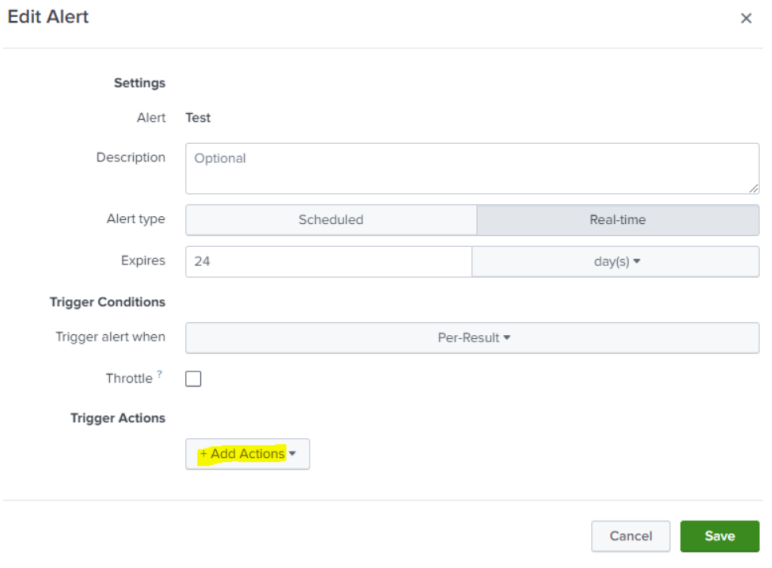

- Create a new alert or edit an existing alert by navigating to the Alert tab in Splunk.

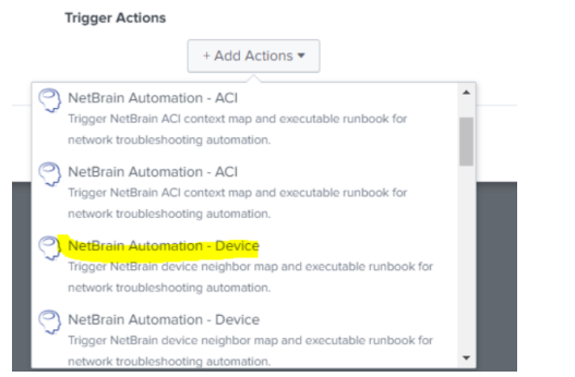

- Click Add Actions and then you will see a list of supported automations. Select NetBrain Automation - Device, which is the type of map that is to be created here.
- Define the following information based on the requirements.
Note: The API Stub name must be same as the stub name created in the NetBrain UI.
