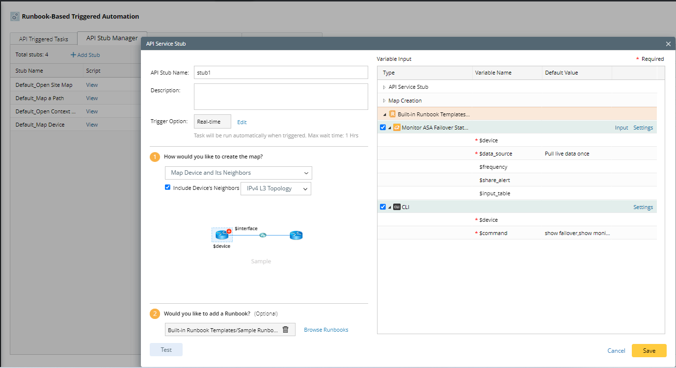

  • Use Triggered Automation to trigger NI:
  • Use API Stub to trigger NI.
    The typical use case is that the 3rd-party system will trigger NetBrain Runbook Template execution, including an NI node. For example, a ticket is created since a BGP neighbor of a core device is flapping, which triggers an API call to the NetBrain System, and the device name and BGP are sent to NetBrain as a keyword. A NetBrain Runbook can filter NIs related to this device and BGP and execute these NIs.

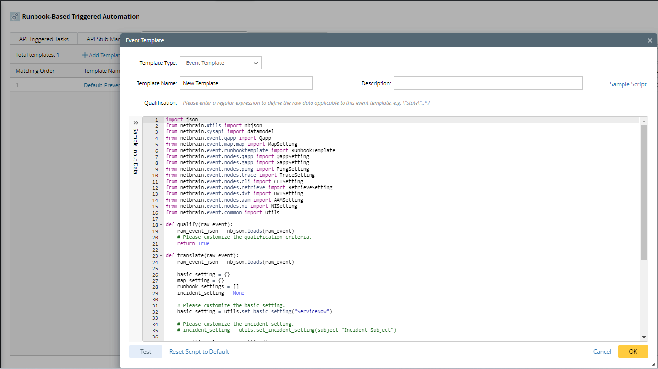

  • Use Event Template to trigger NI:

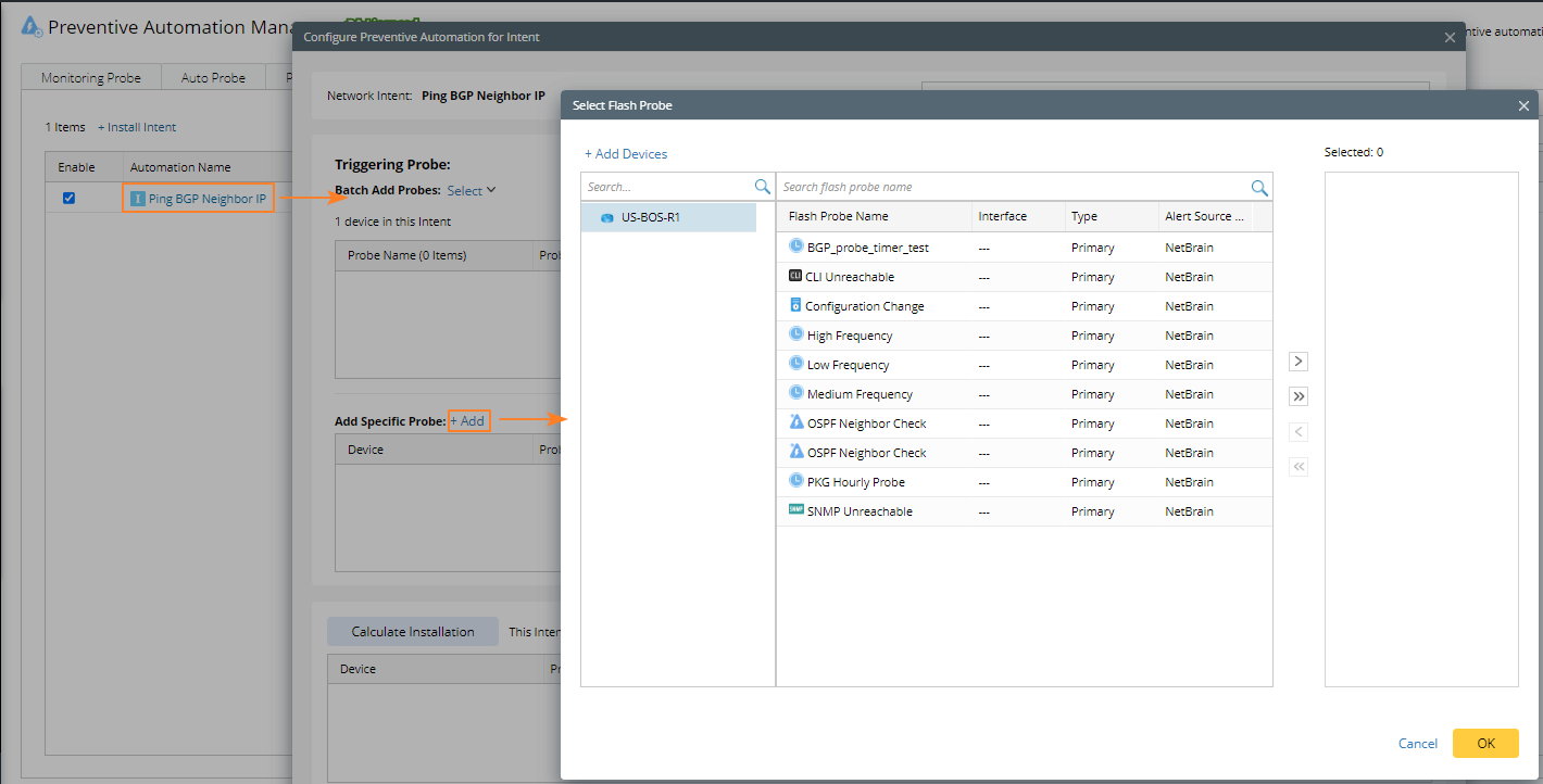

Intents can be triggered by the following three ways in preventive automation:
Information Note: See Preventive Automation via ADT for more information.

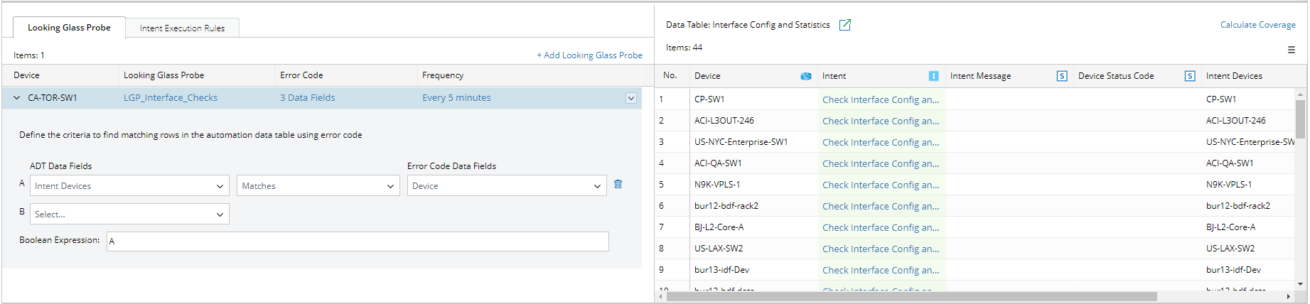

  • Looking Glass Probe:
  • Primary Probe:

Triggered by Flash Probe
A Flash Probe can be added to an NI and a backend process can monitor the whole network's status periodically. When a flash alert occurs, the system will further execute NIs. You can view the triggered NI results with the flash probe via Execution Tree. For example, HRSP NI can be installed as triggered automation of the HSRP state flash probe of the device BJ-L2-Core-A. When an alert occurs on the flash probe, you can trigger the NI to execute automatically.
