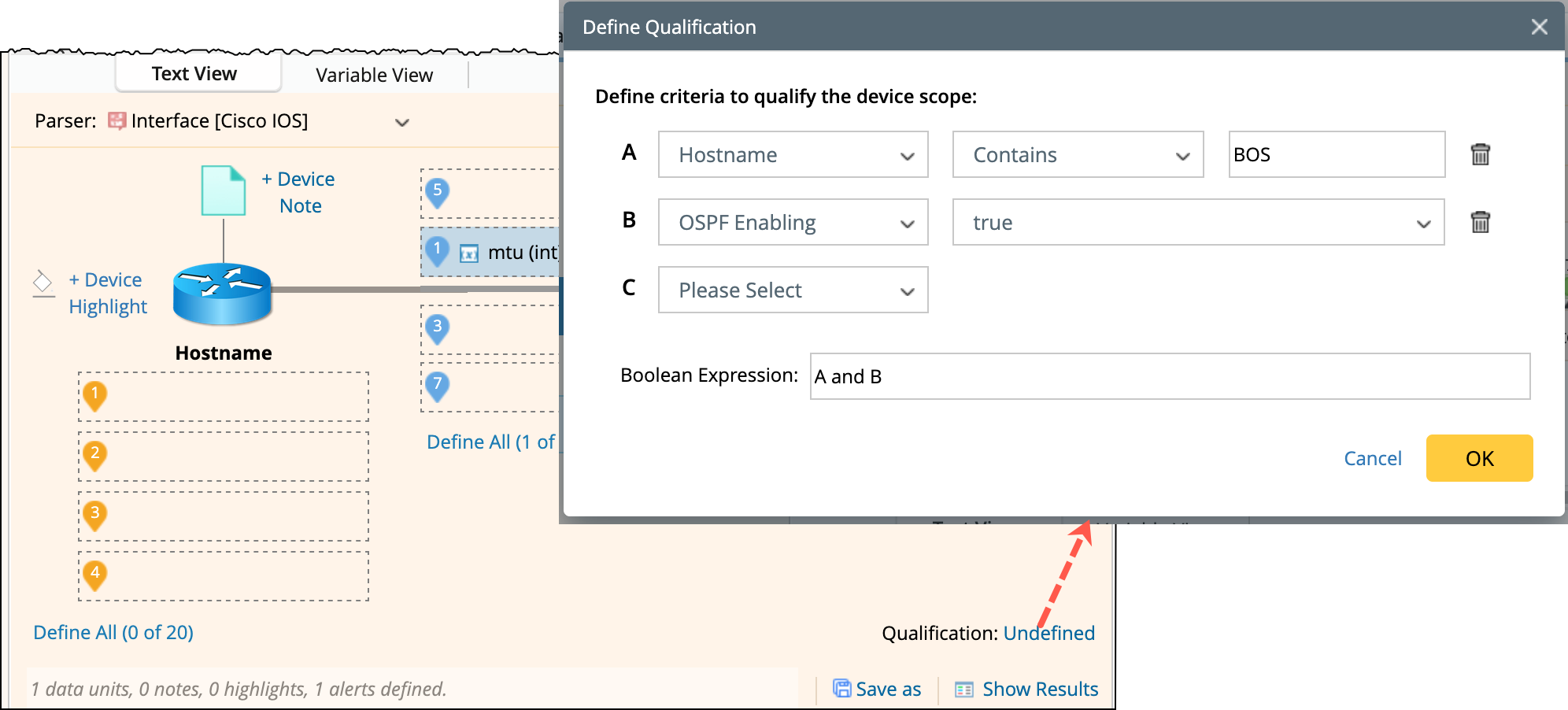

  • Define Qualification:
    Use this option to specify the conditions that devices must satisfy to be considered for execution. These conditions can include device attributes, CLI command outputs, or other custom rules.

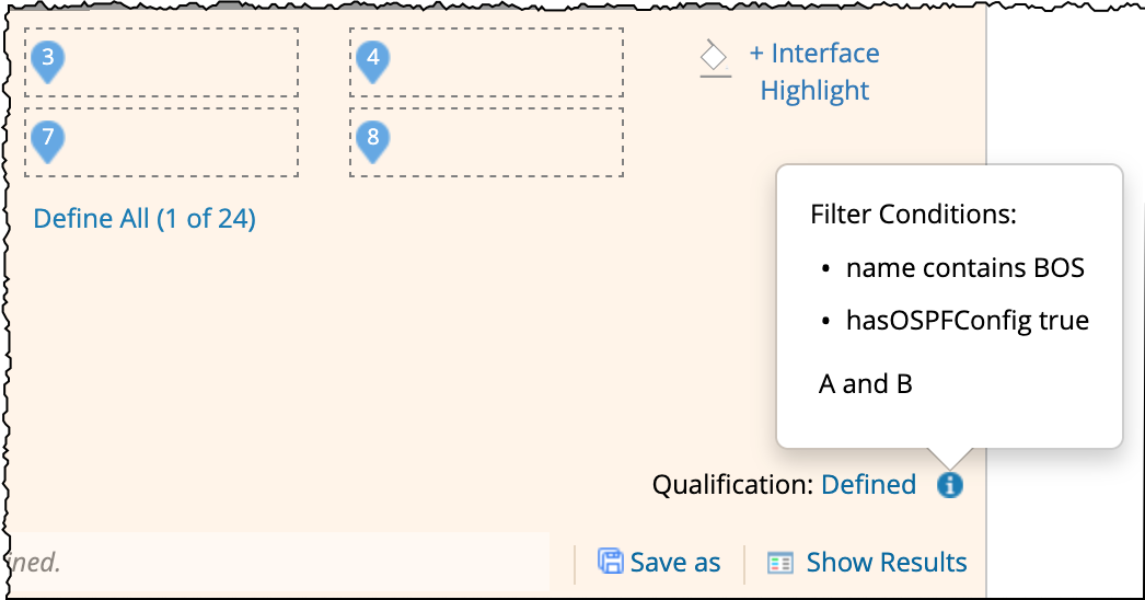

  • View Qualification Details:
    After defining the qualifications, you can view the criteria to verify or update the conditions applied to the node. This helps in maintaining transparency and accuracy in device targeting during automation.
