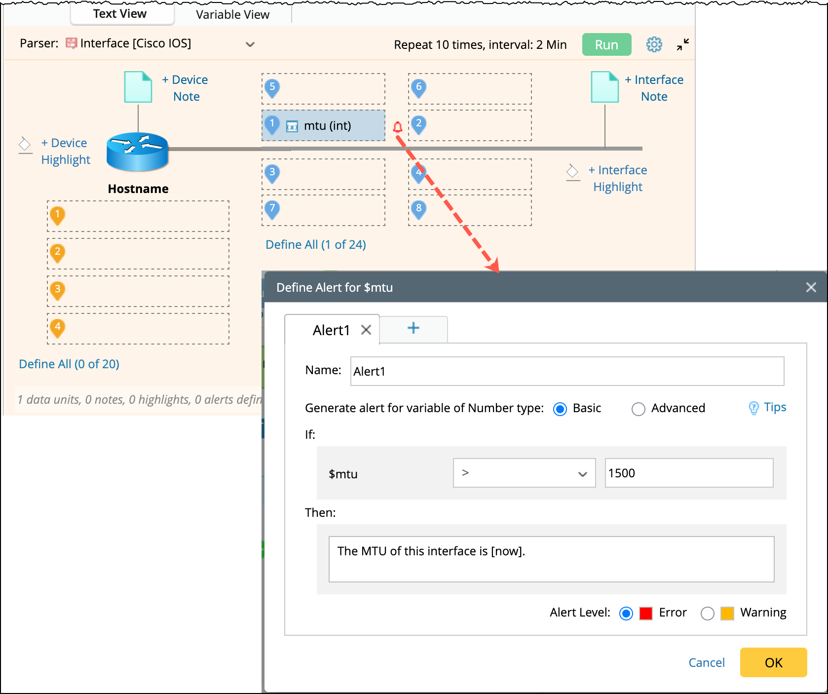

You can define the details of alerts. The entrances of defining alert:

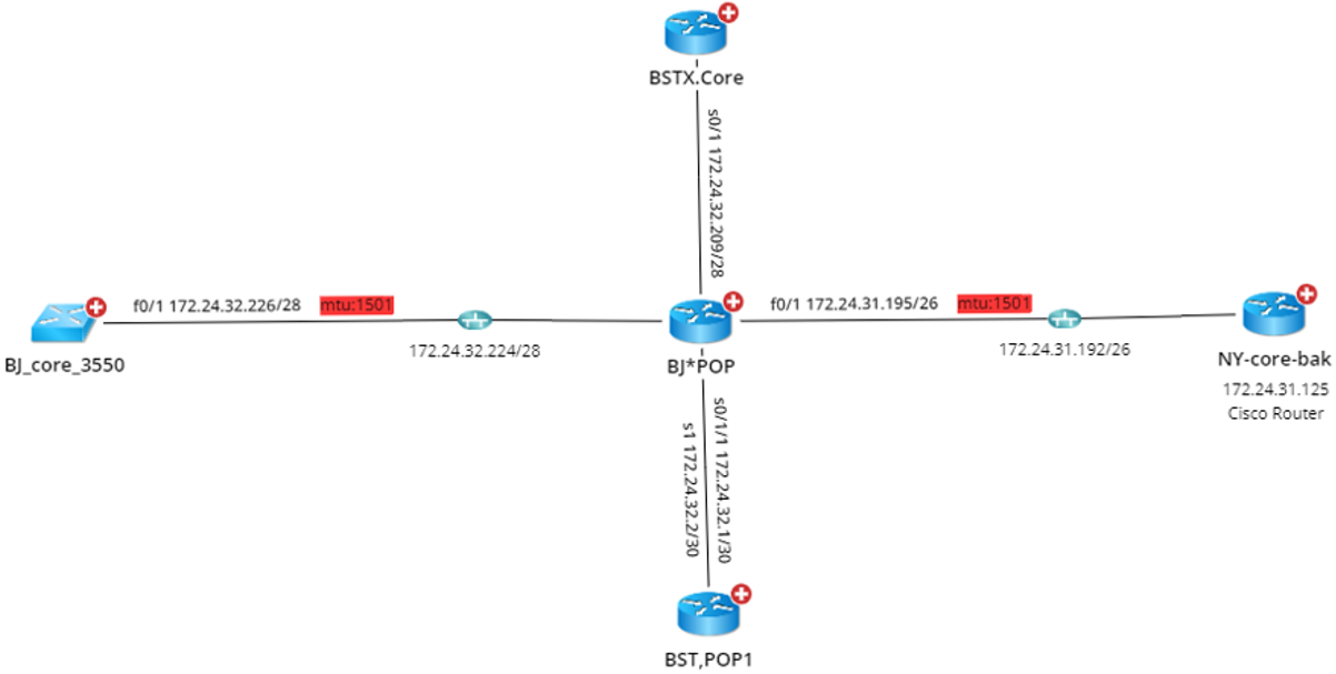

With the above alert definition, the "mtu" data unit shown on the map will be highlighted if the specified condition matched:

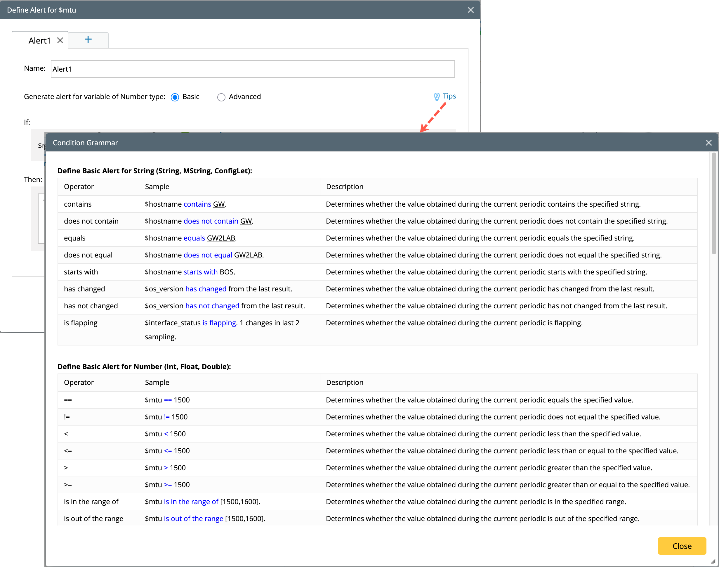

The following table lists the operations supported by the Variable types (string, number, and bool):
| Variable Type | Operation | Grammar |
| String | contains | $var1 (contains) ____. |
| String | does not contain | $var1 (does not contain) ____. |
| String | equals | $var1 (equals) ____. |
| String | does not equal | $var1 (does not equal) ____. |
| String | starts with | $var1 (starts with) ____. |
| String | has changed | $var1 (has changed) from the last result. |
| String | has not changed | $var1 (has not changed) from the last result. |
| String | is flapping | $var1 (is flapping). __ changes in last __ sampling. |
| number | == | $num1 (==) __ |
| number | != | $num1 (!=) __ |
| number | < | $num1 (<) __ |
| number | <= | $num1 (<=) __ |
| number | > | $num1 (>) __ |
| number | >= | $num1 (>=) __ |
| number | is in the range | $num1 (is in the range of) __. |
| number | is out of the range | $num1 (is out of the range) __. |
| number | has changed | $num1 (has changed) from the last result. |
| number | has not changed | $num1 (has not changed) from the last result. |
| number | is flapping | $num1 (is flapping). __ changes in last __ sampling. |
| number | is increasing | $num1 (is increasing) in last __ sampling. |
| number | is decreasing | $num1 (is decreasing) in last __ sampling. |
| number | delta | $num1 (delta) (>). (PS. [delta] = [now] - [last]) |
| number | abs(delta) | $num1 (abs(delat)) (>). (PS. Abs(delta) means rangeability) |
| bool | equals | $var1 (equals) ____. |
| bool | does not equal | $var1 (does not equal) ____. |
| bool | has changed | $var1 (has changed) from the last result. |
| bool | has not changed | $var1 (has not changed) from the last result. |
| bool | is flapping | $var1 (is flapping). __ changes in last __ sampling. |
Added tip to help users understand special syntax and operators.
