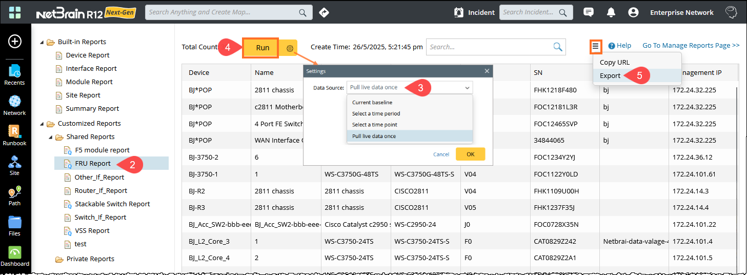

- In the left pane, select a Qapp report. The report data is displayed with the data generated last time.
- For the predefined Qapp report, the data source is the live network by default. To change the data source, click the
icon.
- Click Run to retrieve data for the Qapp report with the specified data source.
- Click
and choose Export.
Tip: The default location of the exported file is C:\Users\<your username>\Downloads. If the outputs of the selected Qapp contain several CSV reports, you can only select one sheet to export.

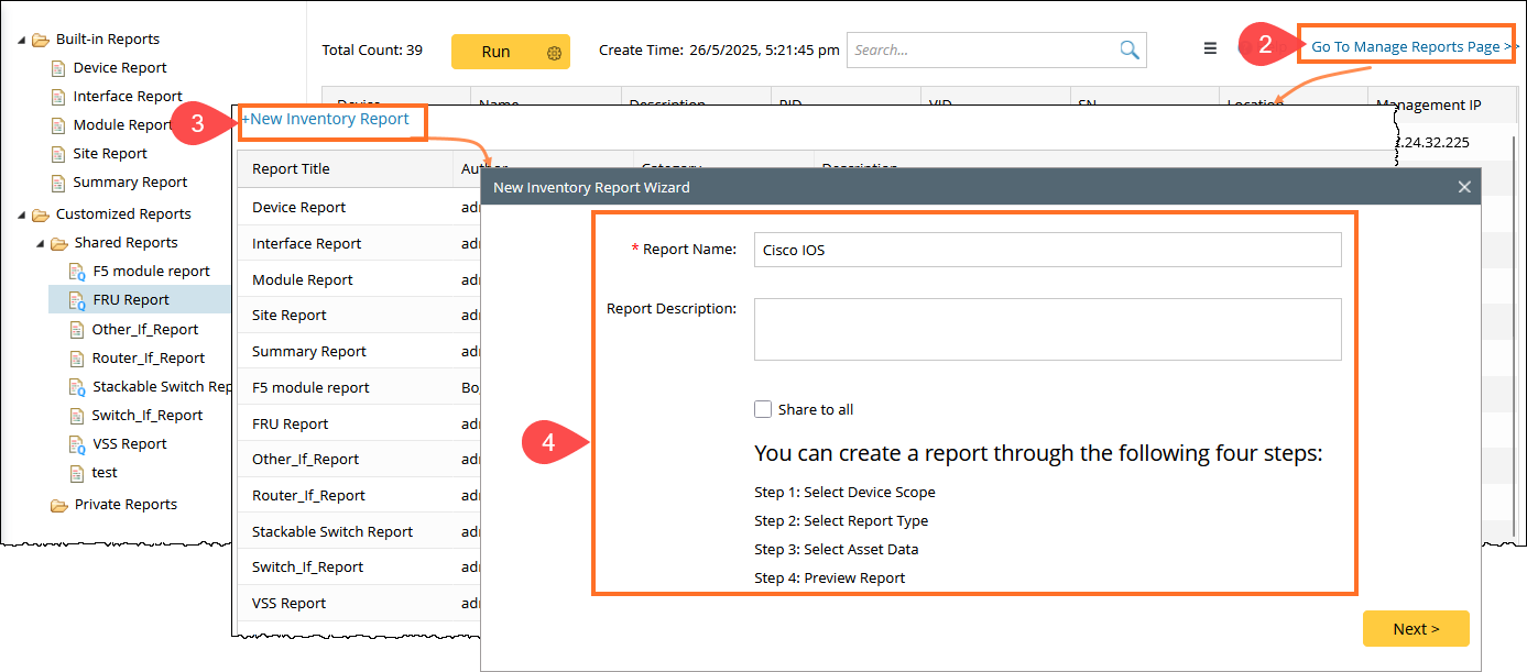

- Click Go to Manage Reports Page at the upper-right corner.
- Click New Inventory Report on the new page. A wizard will prompt to guide you through the steps to create a report.
- Enter the report name and description, and then click Next.

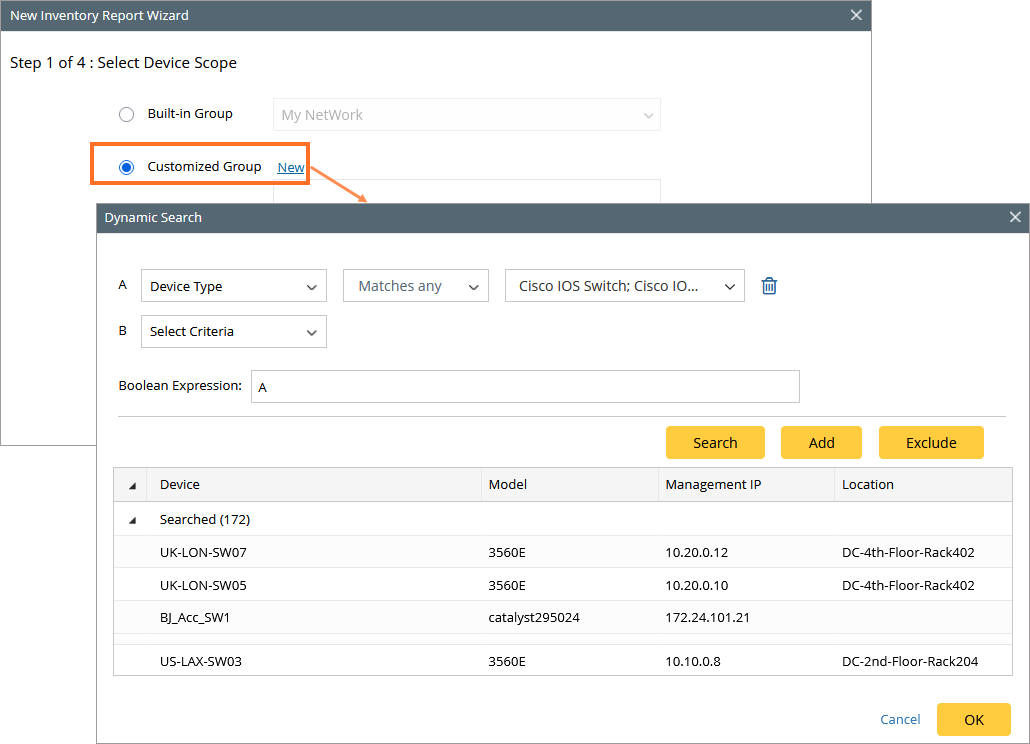

Tip: To make the report accessible to more users in the current domain, you can select the Share to all check box, which will be categorized into Customized Reports > Shared Reports. - Specify the devices to be included in the inventory report. Then click Next.
- Customized Group —click New, and then filter the devices, interfaces, modules, and the like, by setting criteria in Dynamic Search.

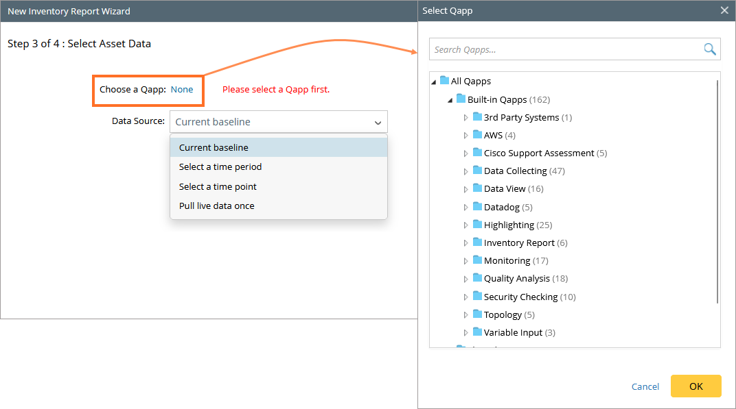

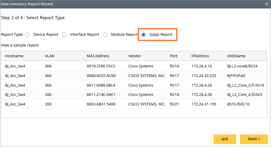

- Select Qapp Report as the report type, and the corresponding sample of a Qapp report will be displayed for reference. Click Next.
- For the Qapp report, you need to select a Qapp with report output and specify the data source. Click Next.

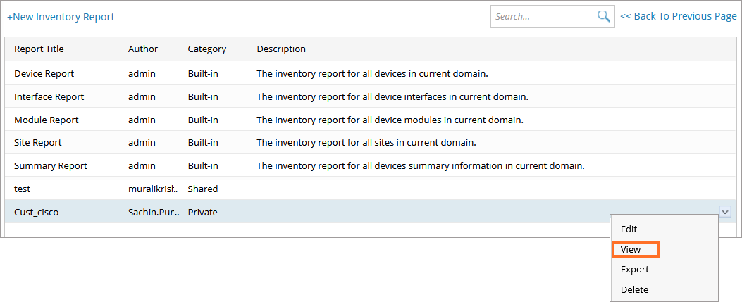

- To view the created report, point to the report entry and then click the
icon to select View.
