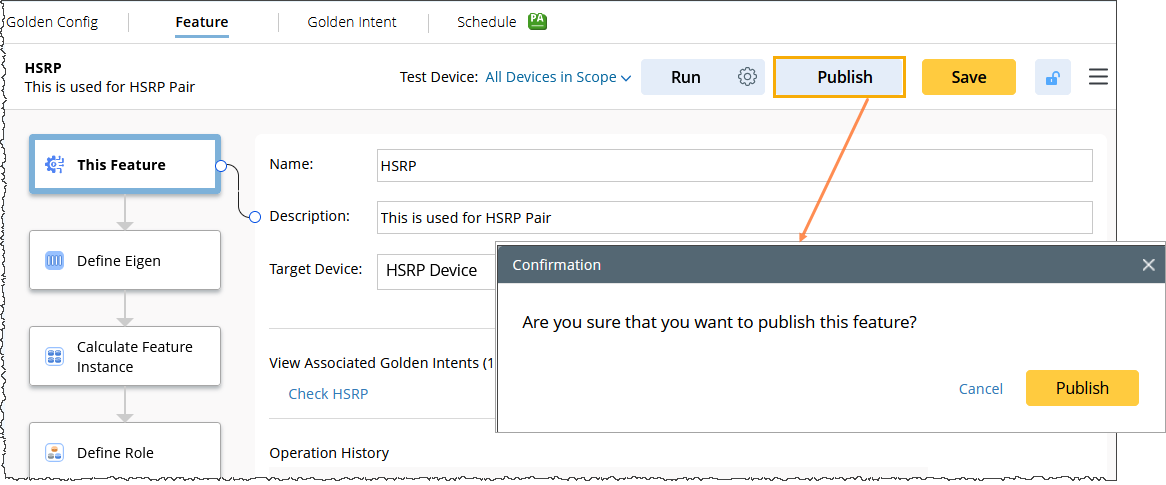

The Publish button will be enabled after the feature is executed using the Run button with the Test Device selection as All Devices in Scope. Once the feature has been published to the production environment, feature instance data can be used to build member intents with the specified GI.

Note: Before clicking the Publish button, check whether the current feature definition matches the definition from the last run. If the definition does not match, you will be prompted to run feature discovery again to avoid confusion from inconsistencies between the result and definition.
  1. Click Publish, and a confirmation dialog will appear.
  2. Select Publish to proceed.
