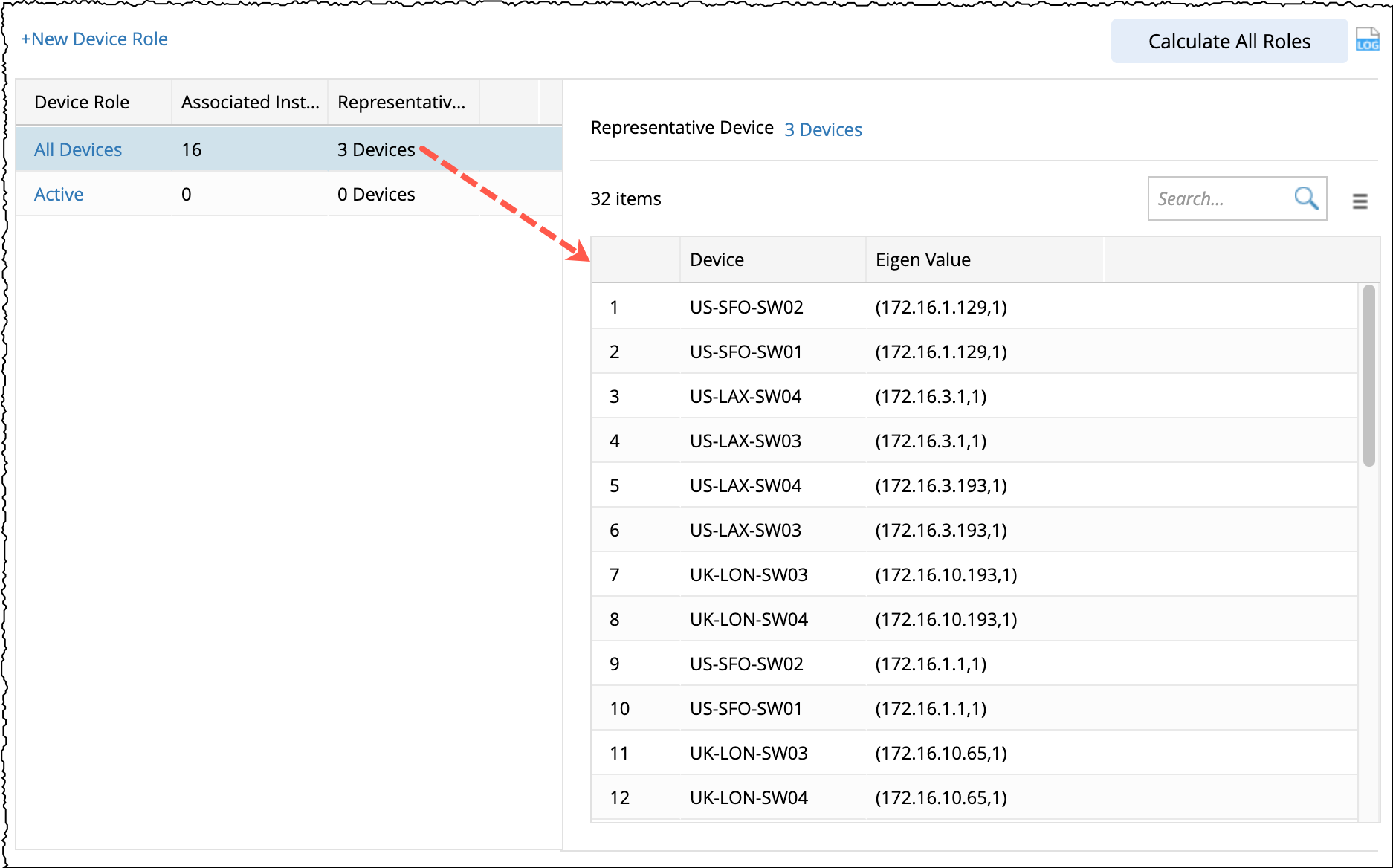

The Role table consists of the following columns:
  • Device Role: Displays the name of the role.
  • Associated Instance: Displays the count of the Feature instances belonging to this Role. You can view the associated instances by clicking on the number.
  • Representative Device: Displays the count of representative devices associated with this role.
  • By default, the All Devices Role is displayed, which includes all the devices associated with Feature Instances calculated in the node Calculate Feature Instance. The All Device Role cannot be modified or deleted.

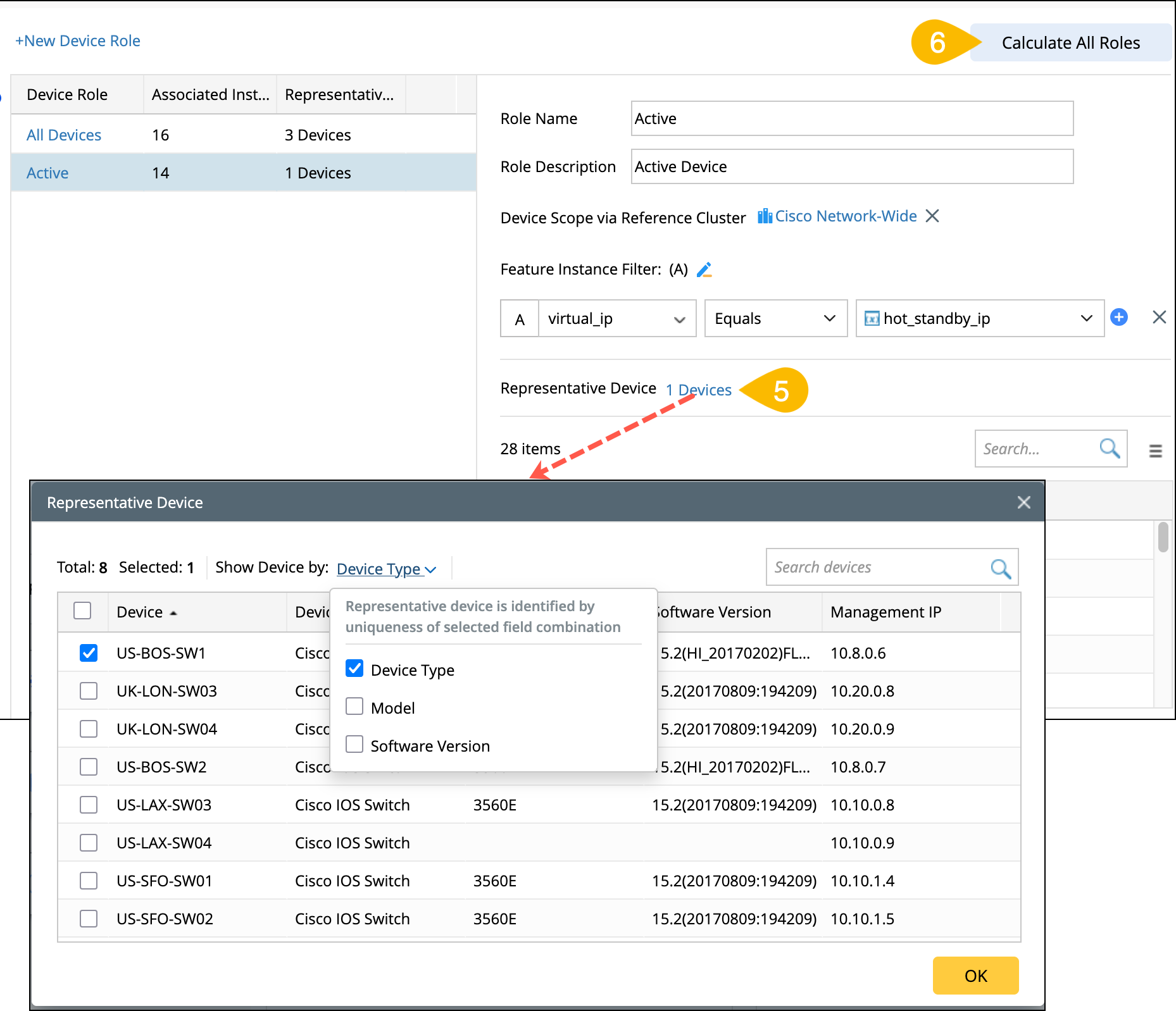

Add a New Role
To add a new device role, follow these steps.
  1. Click the +New Device Role link.
  2. Enter the Role Name and Role Description in their respective text fields.
  3. Device Scope via Reference Cluster: Select a reference cluster.
  4. Define criteria to refine the feature instance filter and retrieve the applicable devices from the device scope list.
  5. Click the Representative Device number to see the specific Representative devices. The reference devices are identified based on the combination of selected parameters (Device Type, Model, Software Version). By default, Device Type is selected in the filter.
  6. Click the Calculate All Roles button to recalculate the associations between all roles and feature instances. The calculation process uses the instance results from the Calculate Feature Instance node.
  7. Information
    Note: When you modify the role definition, an asterisk (*) symbol appears on the Calculate All Roles button as a reminder to recalculate the Roles.
To see the definition and feature instance calculation results of a specific role, select the device role, and its corresponding details will be displayed on the right side.
