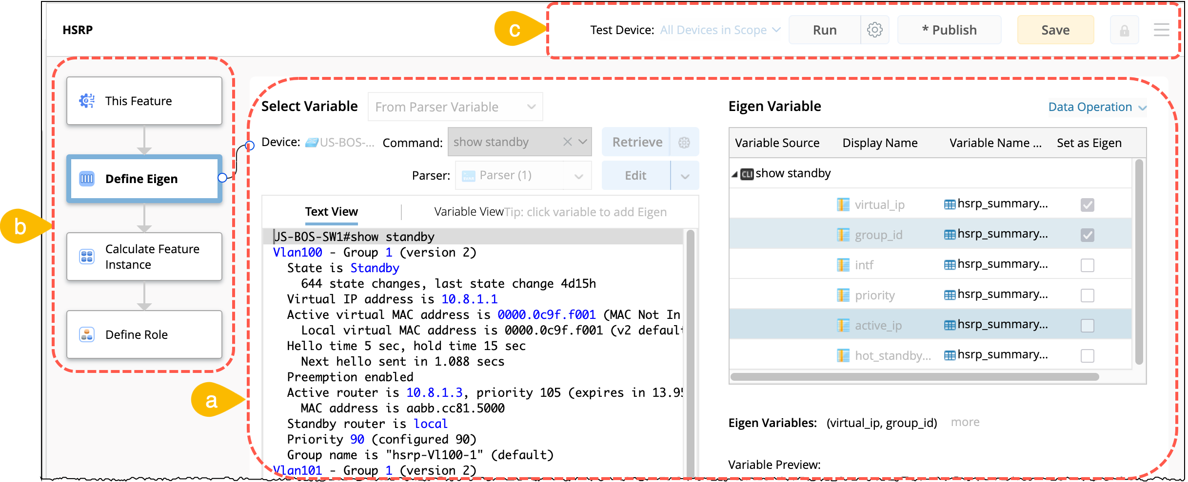

  • Content of the variable table in the upper right corner, along with the corresponding self-contained parser.
  • Eigen variable settings, for example: ($var1, $var2) – sort.
  • Calculate Feature Instance
  • Minimal Device Count setting for one Feature Instance.
  • Published instance result.
  • Define Role
  • Role definitions.
  • Correspondence between published instances and roles.
  • When the golden feature is executed and re-published, the data from Node 3 and Node 4 will be updated in the corresponding Published Dataset.
