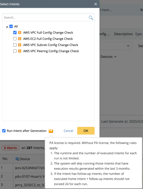

Assessment Rule → Golden Intent Generator → Generate
Without PA license, the icon is shown for batch run intents once

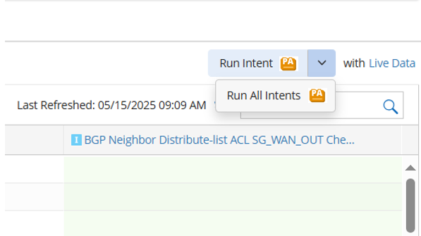

Assessment Rule - Golden Intent Results → Run Intent
Without PA license, the icon  is shown for batch run intents once.

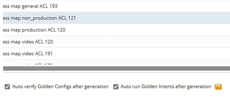

Rule Discovery → Auto Run Golden Intent after Generation
Assessment Library - > Generate Golden Assets → Settings

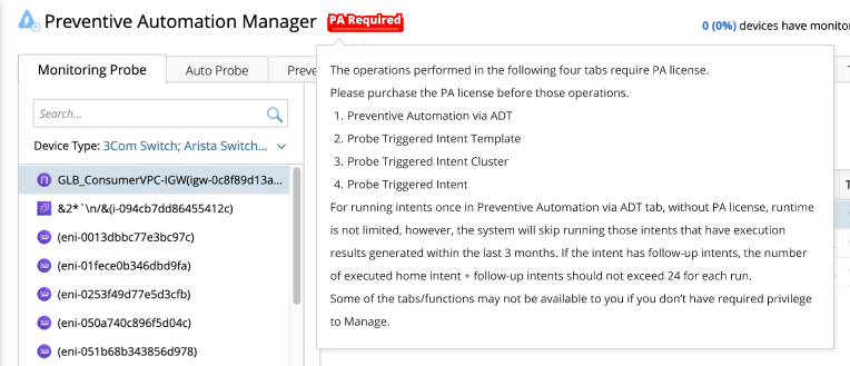

Preventive Automation Manager
The icon is shown without PA license.

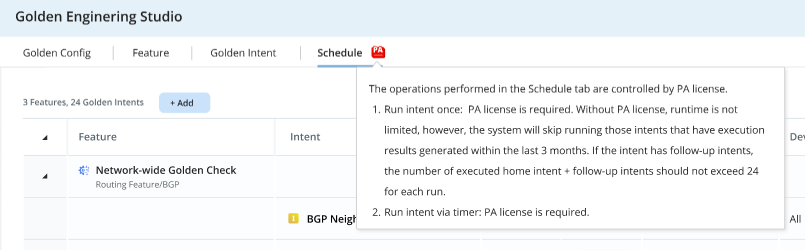

Golden Engineering Studio (GES) - Schedule

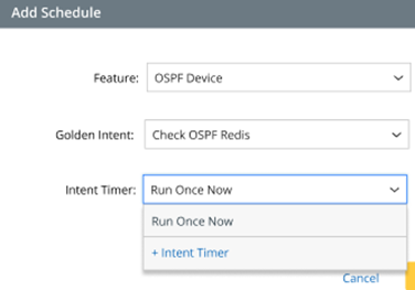

Without PA license, only Run Once Now is selectable when the schedule is defined.
