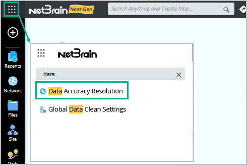

  1. Search the keyword "Data" in the start menu or log in to the Domain Management page, and then click Data Accuracy Resolution on the Start Page

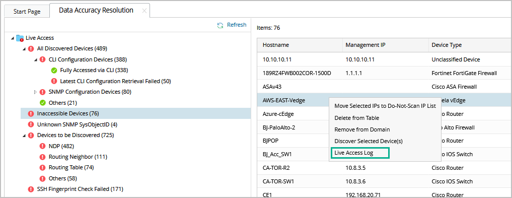

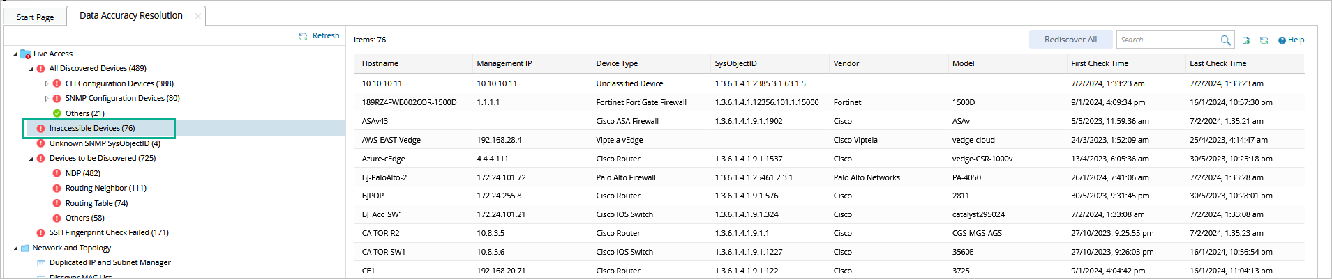

  1. In the  Data Accuracy Resolution tab, click Inaccessible Devices in the left pane to list out the devices.
  1. Select the devices, right-click them, and select Discover Selected Device(s).
    Information Tip: if you want to discover all devices in this list, you can click Rediscover All in the upper right corner.

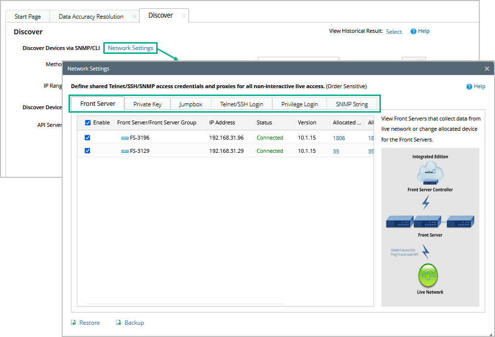

    2. Select one access method according to the configuration on your devices.
    3. Click Network Settings to specify the proxies and credentials used in the discovery or keep it as default.

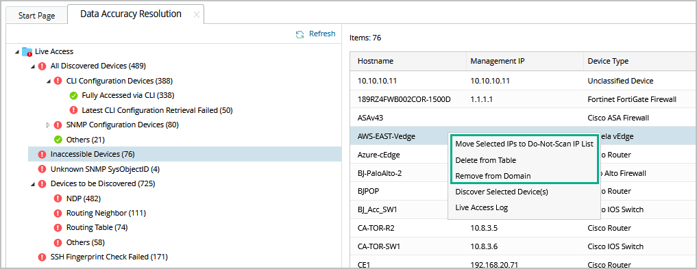

    5. If these devices are rediscovered successfully, they can be automatically moved from the Inaccessible Devices category to the Fully Accessed via CLI category. Otherwise, you can manually remove, delete, or move them to the Do-Not-Scan IP list. See more details in Do-Not-Scan list.
