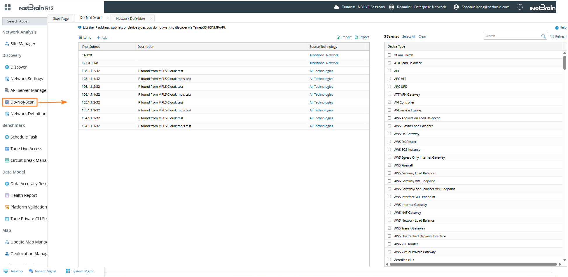

Before discovering a network, you can create a Do-Not-Scan list with specific IP addresses or subnets, Device types, and Hostname that you do not want to discover in your network. Consequently, the related devices are ignored during the discovery process.
The Do-Not-Scan interface in the Domain Management Page consists of three tabs:
  • IP or Subnet - To exclude by IP addresses or subnet ranges.
  • Device Type - To exclude by device types.
  • Hostname - To exclude by hostname patterns.
Each tab allows you to define exclusion rules to prevent specific devices from being discovered.
