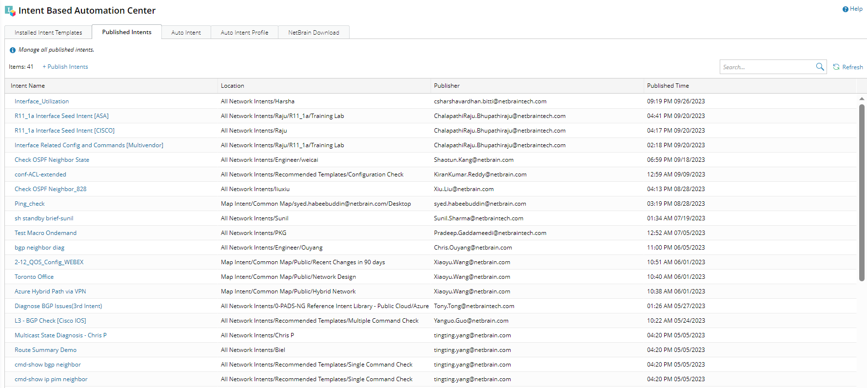

Publish Intents in IBA Center
Published intents are displayed in the Published Intents pane as a table.
  • Intent Name: A link to the published intent. You can click the intent name to view the intent details.
  • Location: The location where the published intent is stored in the system.
  • Publisher: The username of the user who published the intent.
  • Published Time: The time when the intent is published.
You can perform the following two operations from the drop-down menu of a published intent item:
  • Click View Details to view the published intent details in View-Mode.
  • Click Unpublish to unpublish the intent and remove the intent from this pane.

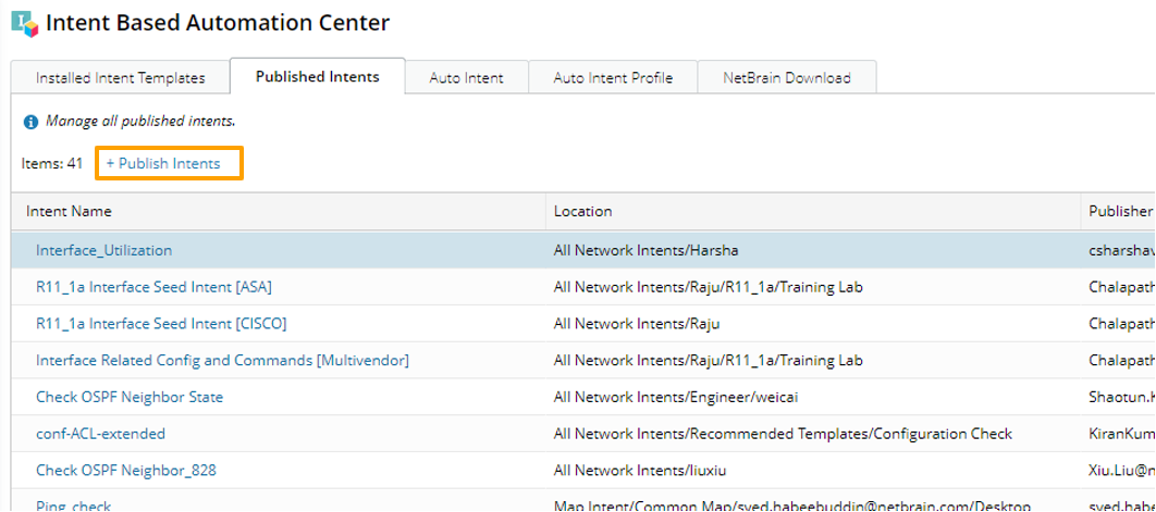

Publish Intents in Batch
Under the Published Intents tab, you can publish intents in batch.
  1. Go to IBA center>Published Intents.
  2. Click + Publish Intents.
  3. In the Select Network Intents dialog, select some intents or folder of intents to publish by checking the checkbox of the intent/folder.
The following two options help to filter intents before intent selection.
  • Show Intents with Template Qualifications Defined Only: If you select the checkbox to enable this function, all intents that can be used as template are filtered and displayed.
  • Show Published Intents Only: If you select the checkbox to enable this function, all the published intents are filtered and displayed.

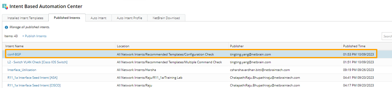

  1. Click OK to publish selected intents. The published intents will be added under the Published Intents tab and listed under the Published Intents pane of a Map having the same device as the published intent.
