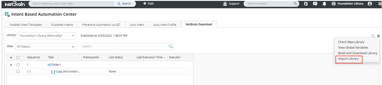

  1. Navigate to the IBA center (Intent Based Automation Center) > NetBrain Download.
  2. To import the library shared with you, click and select Import Library from the drop-down list.

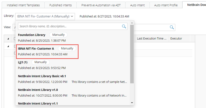

  4. Click Finish when the library has been imported successfully. The library will be available in the Library drop-down list.
  5. Click  to open the Library drop-down list, and select the library you just imported.

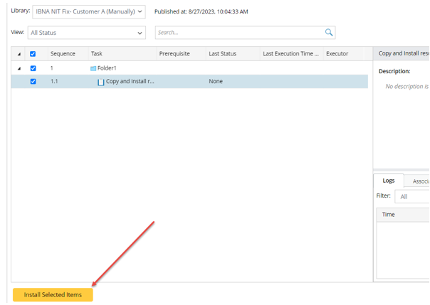

  6. Click the Install Selected Items button to install the selected library.
  7. After the library is installed, all the NITs will be updated.
