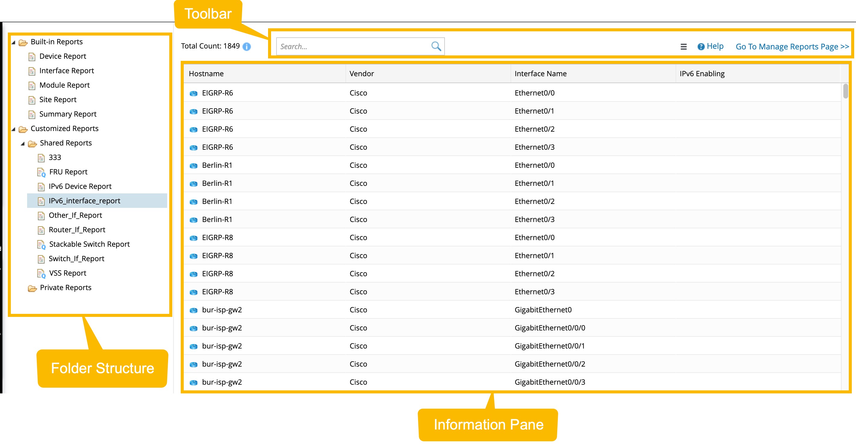

    UI Components of Inventory Report
    The UI components of the Inventory Report are illustrated below:
    • Folder structure pane: The left pane displays an inventory report folder tree that categorizes all the inventory reports into the respective category of the folder.
    • Information pane:  The right pane displays the asset details of a selected inventory report.
    • Inventory report toolbar: A place where you can carry out inventory report-related operations, such as searching.

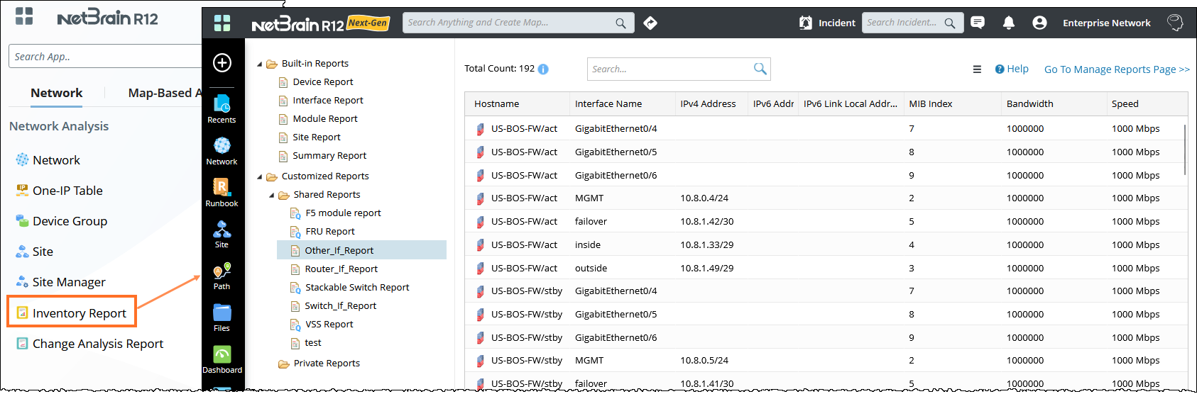

    The following types of inventory reports are supported in the NetBrain System.
    Category Type Description
    Built-in Reports Device Report Contains properties of devices in the current domain, such as management IP and device type.
    Interface Report Contains the interface properties for all devices in the current domain, such as IPv4/6 address and bandwidth.
    Module Report Contains the module properties for all devices in the current domain, such as module ports and slot numbers.
    Site Report Contains the summary information for all sites in the current domain, such as location and device count.
    Summary Report Contains the summary information for all devices in the current domain, such as module count and interface count.
    Customized Reports Shared Reports
    Visible and editable to all users in the current domain.
    • FRU Report — contains the chassis hardware information about Cisco routers, Cisco IOS switches, Juniper routers, and Juniper EX switches in the current domain.
    • Stackable Switch Report — contains the stack information about Cisco Routers or IOS Switches in the current domain.
    • VSS Report — contains VSS modules in the current domain.
    • Router_If_Report — contains the interface properties for routers in the current domain.
    • Switch_If_Report — contains the interface properties for switches in the current domain.
    • Other_If_Report — contains the interface properties for other device types in the current domain.
    Private Reports Only accessible to the report author.
    Information TipQapp-based Reports are marked with the  icon.
