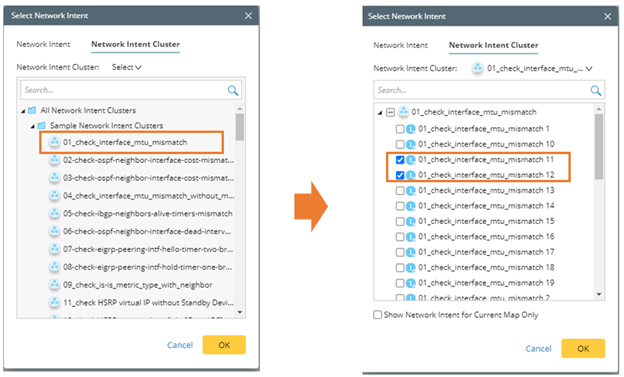

Adding Member Network Intent to Runbook NI Node
  1. On a Runbook, click and select Network Intent from the Select Action window.
  2. Define a Network Intent name and click Add to select the Network Intent.
  3. Click Network Intent Cluster, select the Network Intent Cluster from the list, then select the member NIs to be added.
  4. The selected Member NIs will be added as the Runbook Network Intent node.

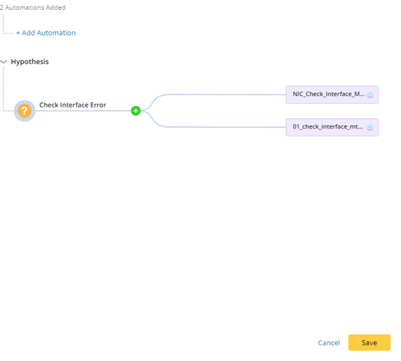

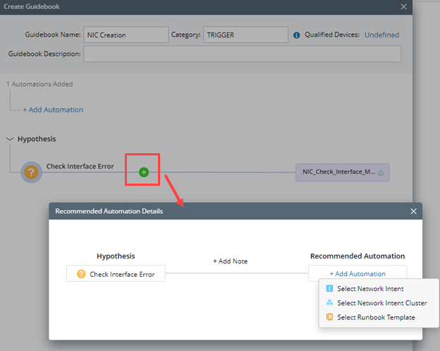

Adding Member Network Intent to Guidebook
    1. In the Create Guidebook window, click , then click Select Network Intent Cluster from the list.
    2. Select the Network Intent Cluster from the list and click OK.
    3. Click Save to save the Guidebook.

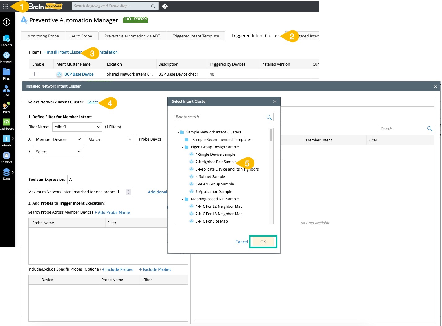

    Follow the steps to add Network Intent as Preventative Automation:
    1. Click and select Preventative Automation Manager.
    2. On Preventative Automation Manager page, navigate to Triggered Intent Cluster pane.
    3. Click +Install Intent Cluster.

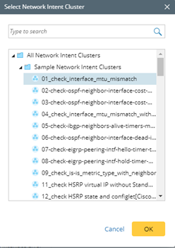

    4. In the Installed Network Intent Cluster window, click Select to choose an NIC.
    5. In the Select Intent Cluster window, select an NIC and click OK.

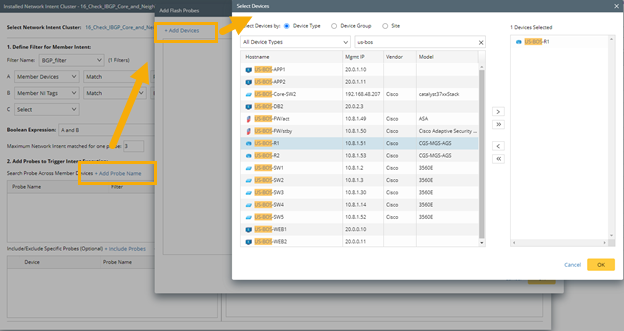

    6. In the Installed Network Intent Cluster window, define the filter for Member NIs so only the Member NIs that match the filter conditions will be installed. The Member NIs can be filtered by member devices and member NI tags.
      Information Note: Member Devices Match Probe Device means Member NI devices match the devices for flash probes defined in step 7 and 8. You can also input device hostnames instead of Probe Device.
    7. Click  + Add Probe Name to dynamically filter and add probes to trigger Intent execution, then click  + Add Devices to select the devices for the probes.
    8. For each probe device, select the flash probes to be added, click    to add the probe and then click OK to close the window.
    9. Click Select a Filter to apply the filters defined the step 6 to the probes.
