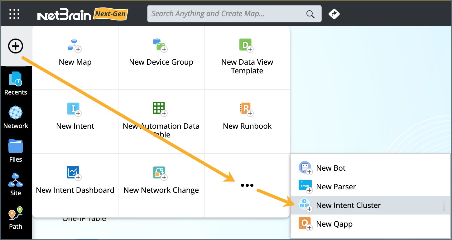

  1. Click >> New Intent Cluster.

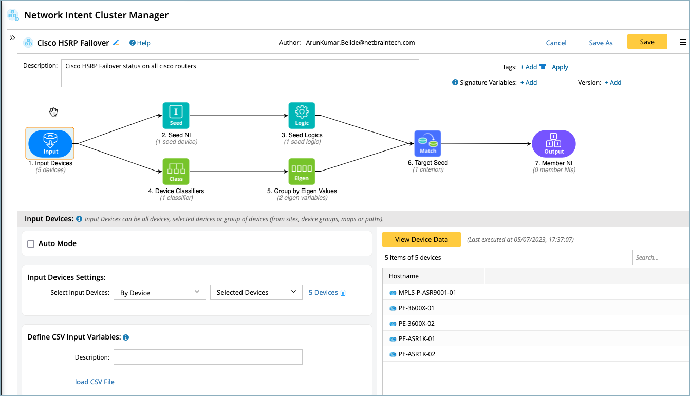

  2. In the Network Intent Cluster Manager window, enter the name and description for NIC.
  3. To define input devices, go to Select Input Devices and select By Device from the drop down menu
  4. Click Select Devices window and choose all the input devices.
    Information Tip: You can also add by device group or by site.
    Information Tip: You do not need to be too specific about the input devices, as they can be filtered later with the device classifier node.
