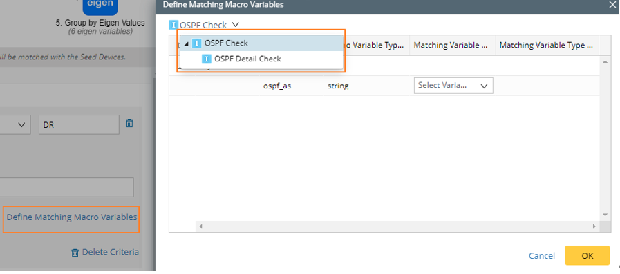

Step 6: Define the Target Seed. Click on +Add Criteria to add matching criteria for Seed Devices. When selecting the Matched Selected Device, users can select the Home NI or Child NIs, and then select the seed logic and devices defined in Step 3.
Users can define matching Macro Variables for both Home NI and Child NI.
