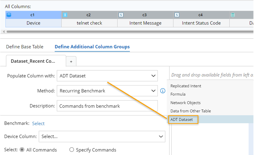

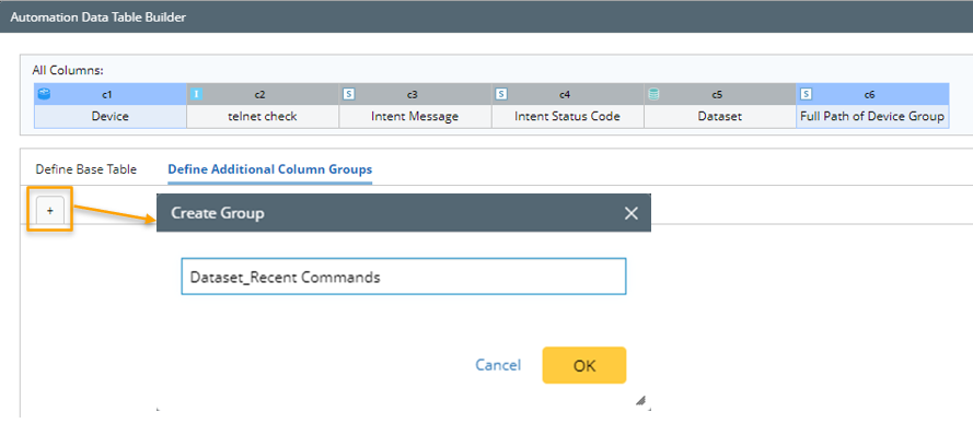

- Go to Automation Data Table Builder, create a Base table, then create a new group and name it (for example, "Dataset_Recent Commands").
Note: It is recommended the Base Table contains device column that is used for creating Dataset column later. - Under the new group tab, define the following basic settings:
- Populate Column with: Select ADT Dataset for building the column group.
- Select the method ADT Dataset > Recurring Benchmark (which is the default setting) to get command data from benchmark.
- Description: Type descriptions for the column group to describe its use and function.
- Select Method to Build Group Table: Select ADT Dataset.

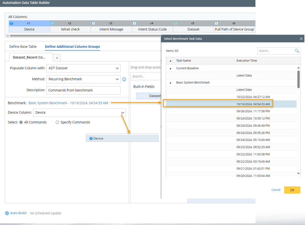

- Select Data from: Keep the default Benchmark option, click Select, then select the benchmark task for building this column group. For more information about the different types of benchmark task data, see Appendix (ADT Dataset).
- Continue to define the following settings:
- Device Column: Select a device column already defined in Base Table. The selected device column in ADT will be the device column of this dataset. Only the command data of the devices in the selected column will be added to the dataset.
- Select All Commands or Specify Commands to determine which commands will be finally added to the ADT dataset.
All commands: Add all the device commands to the ADT dataset.
Specify Commands: Check the checkbox to select commands from the benchmark task. In the current example, we select Specify Command > Configuration File.Tip: To search the commands, click in the search box and input keyword.

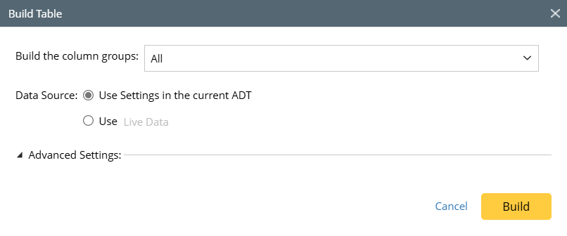

- Click Save and Build, the Build Table dialog will display.
- In the Build Table dialog, select the column groups to be built and select a log mode, then click Build.
