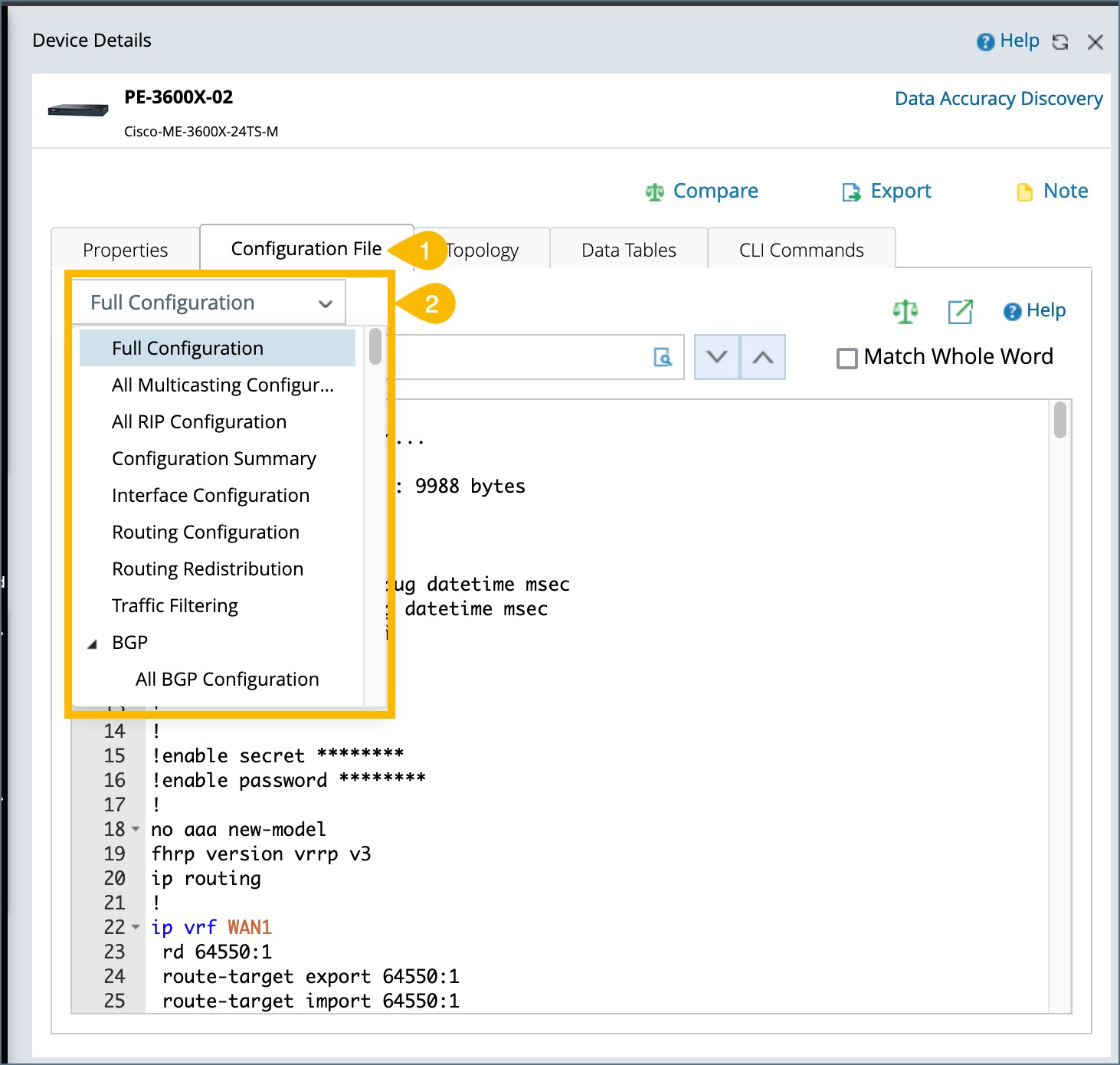

- In the Device Details pane, select the Configuration File tab. The full configuration file of the device is displayed by default.
- Select a technology from the drop-list to filter the configurations.

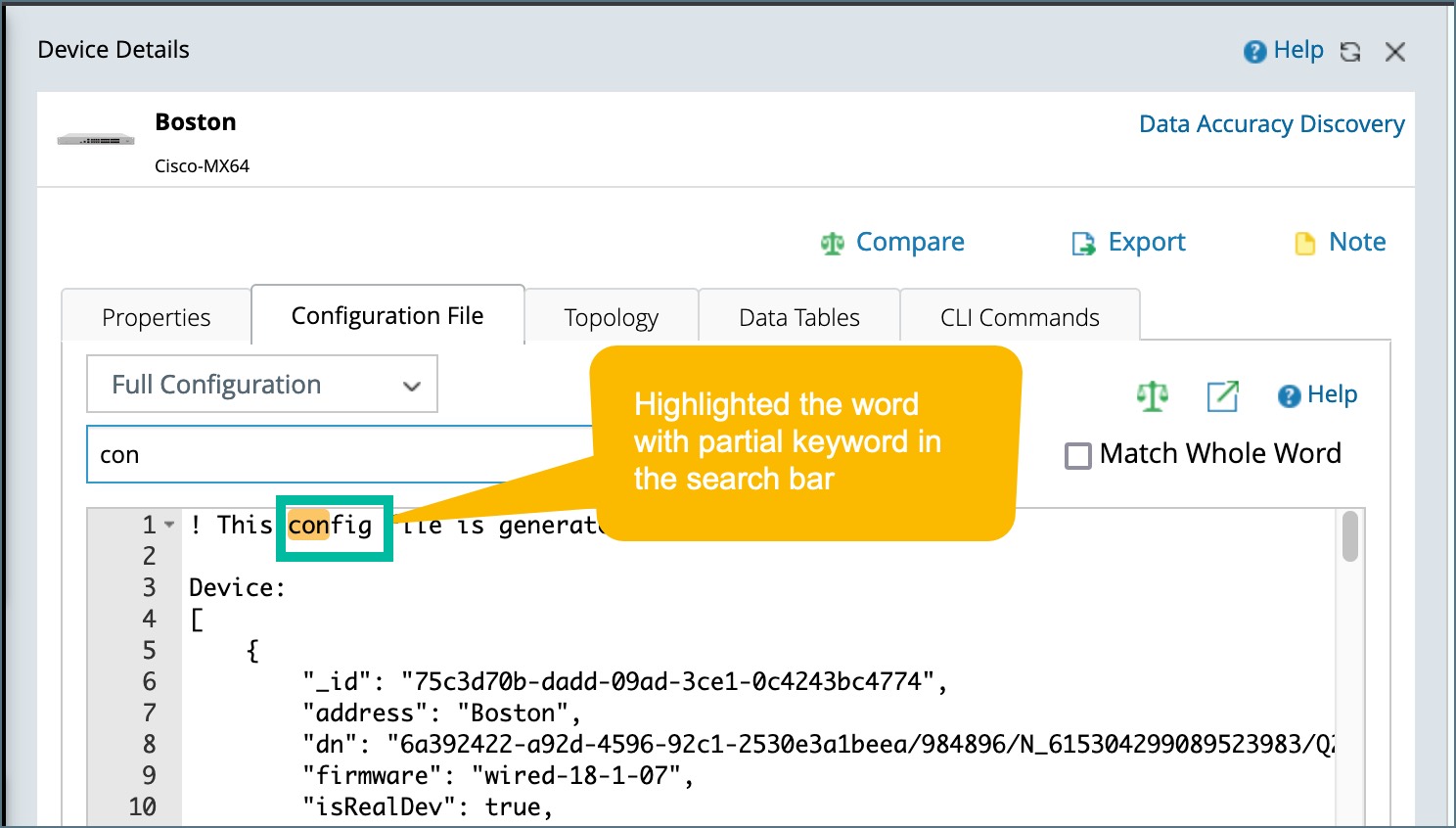

Normal Search: Type the keyword in the search bar, and the system will highlight all words containing the whole or partial keyword. You can use
to browse the next or the previous highlighted items.

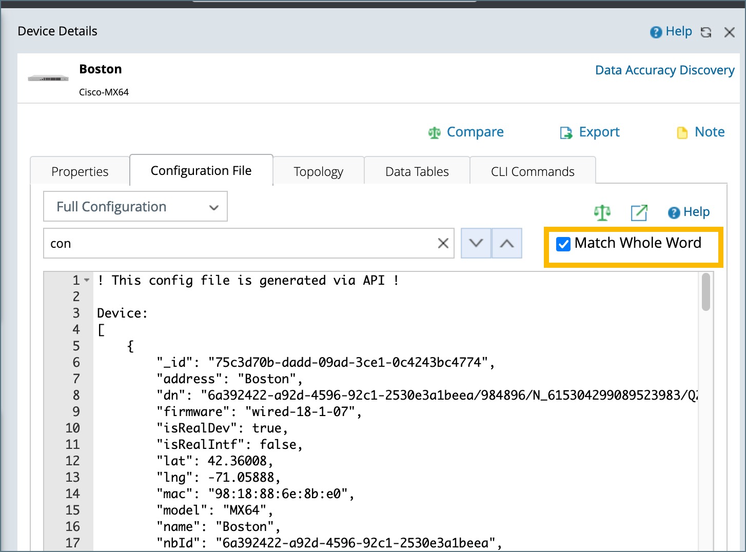

Match Whole Word: Check this box to match the whole word. Type the keyword in the search bar, and the system will only highlight the words that exactly match the whole keyword. You can use

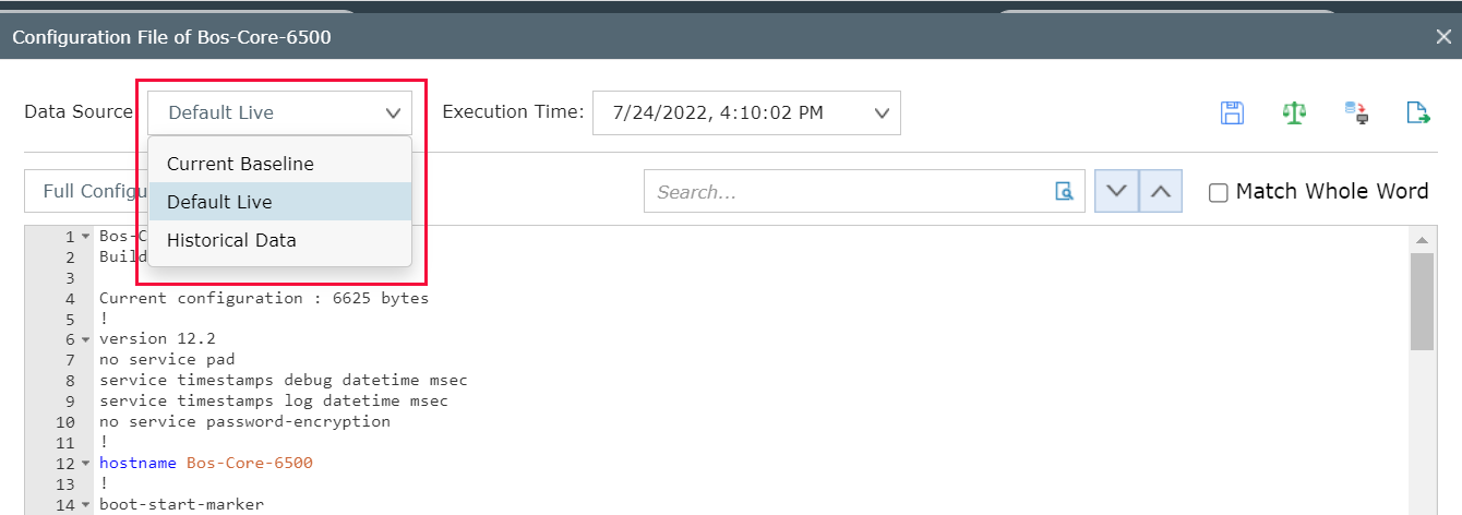

Retrieve Configuration Files from the Live Network
In the Device Detail pane, click
to open the pop-up window.
Click
to retrieve live configuration.
- You can also review configuration files from different Data sources and Execution times.

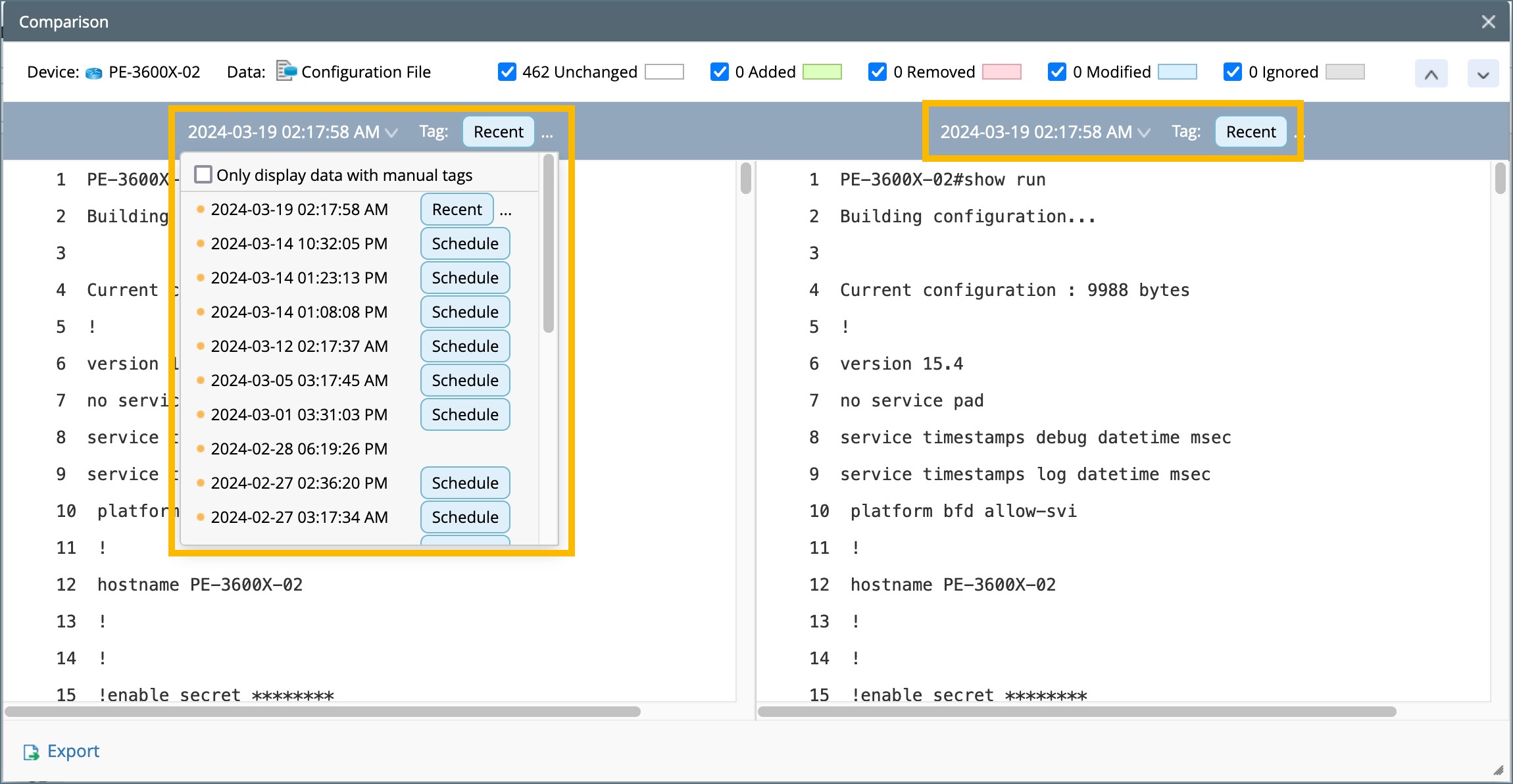

Click
to open the Compare window.

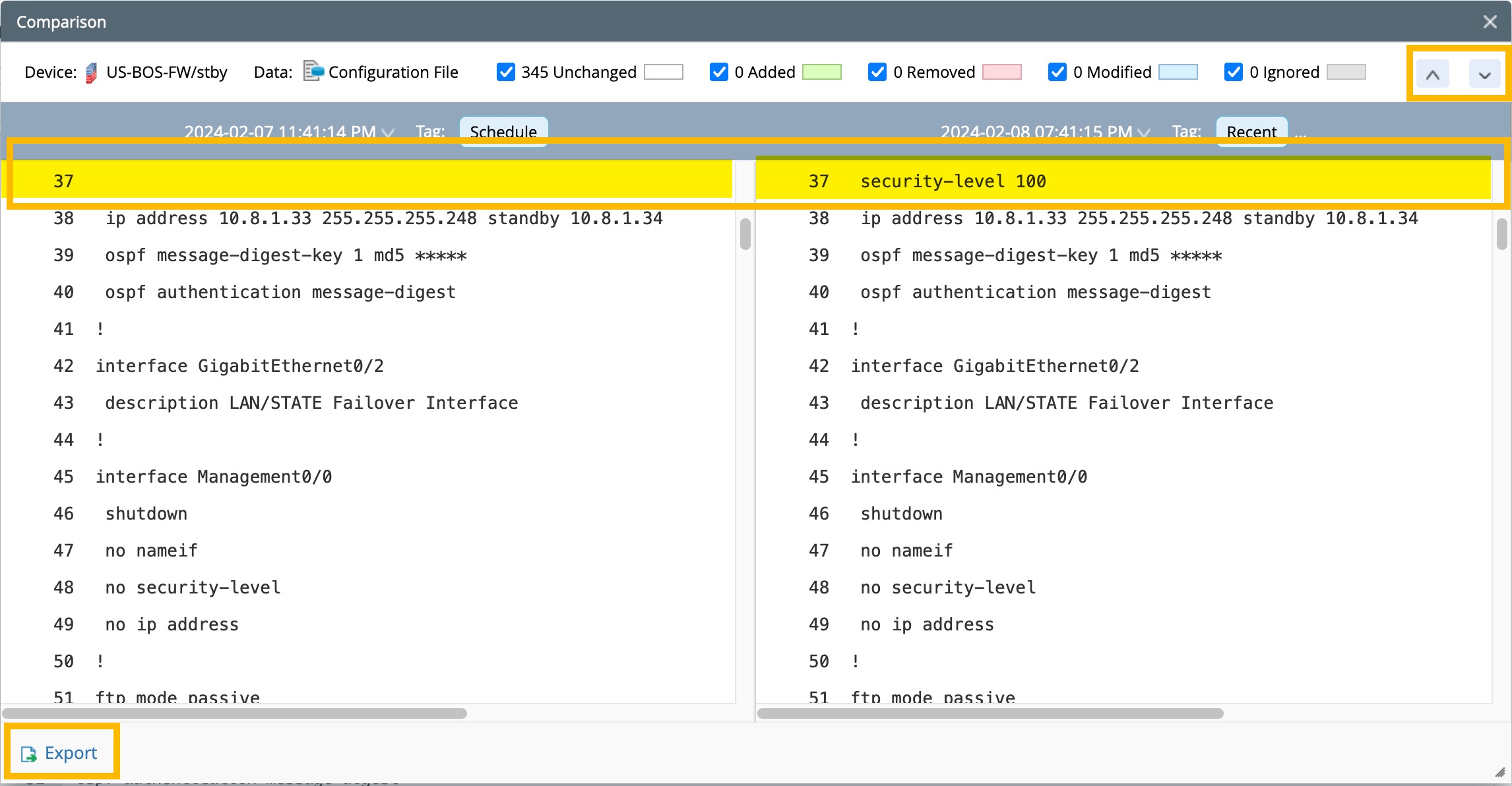

- Select the configuration files from different times to compare.
Use
to find the next changed item. You can also export the comparison result.
