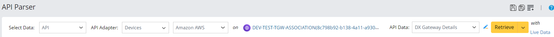

Select API type Select API Adapter Select device (filter devices based on the selected type) Select API Data (adjusting function is moved to this step from API adapter step) Retrieve.

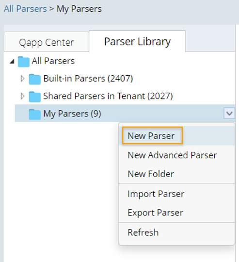

  1. Create a Parser and Name it (e.g., API Parser).

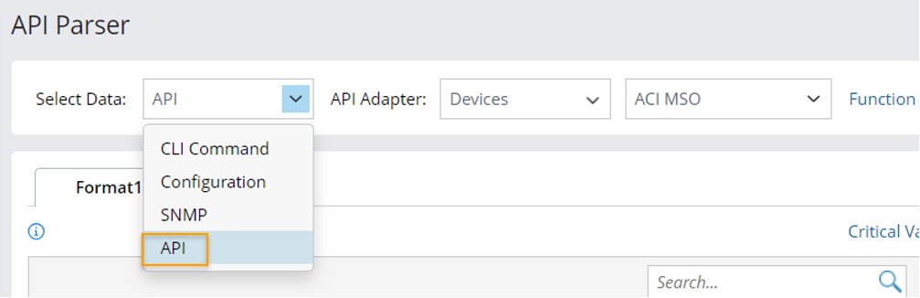

  2. Define the parser as an API type parser by selecting API from the Select Data dropdown.

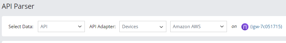

  3. Select API Adapter as Devices, Amazon AWS, and then select to retrieve data on device igw-7c051715

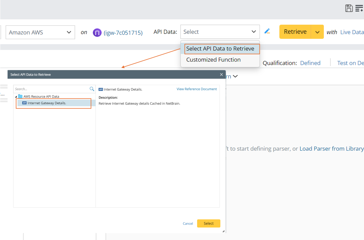

  4. Select Select API Data to Retrieve from the API Data dropdown, then select predefined API data from Library to auto-generate the Python function from the API Library.
    Information Note: API data can be selected because Amazon AWS is available API Data Category in the system.
  5. Alternatively, you can select Customized Function to manually define the function script.
