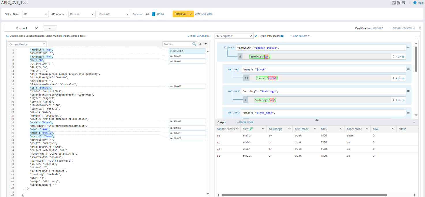

The following screenshot shows a defined API parser.

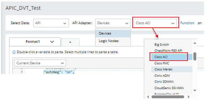

  1. Click the  icon on the taskbar and select New Parser.
  2. In the Select Data list, select API.
  3. In the API Adapter field, select Devices of Cisco ACI

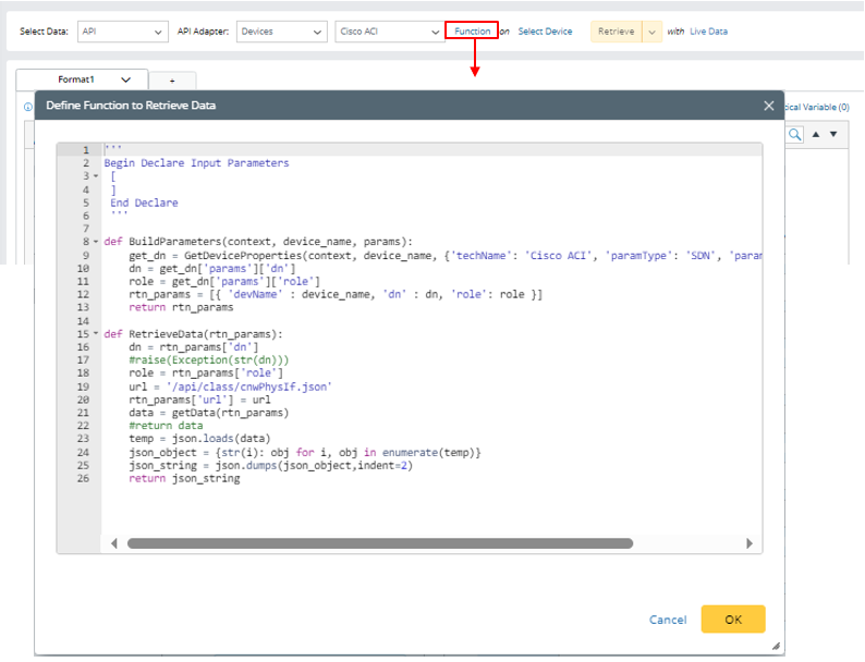

  • Click Function, then define the functions to retrieve raw data by inputting or copying-and-pasting scripts. In this case, the system pulls parameters such as interface name, MTU data.
    A sample script is given below:
    JSON
    Begin Declare Input Parameters
    End Declare
    def BuildParameters(context, device_name, params):
    get_dn = GetDeviceProperties(context, device_name, {'techName': 'Cisco ACI', 'paramType': 'SDN', 'params' : ['dn','role'] })
    dn = get_dn['params']['dn']
    role = get_dn['params']['role']
    rtn_params = [{ 'devName' : device_name, 'dn' : dn, 'role': role }]
    return rtn_params
    def RetrieveData(rtn_params):
    dn = rtn_params['dn']
    #raise(Exception(str(dn)))
    role = rtn_params['role']
    url = '/api/class/cnwPhysIf.json'
    rtn_params['url'] = url
    data = getData(rtn_params)
    #return data
    temp = json.loads(data)
    json_object = {str(i): obj for i, obj in enumerate(temp)}
    json_string = json.dumps(json_object,indent=2)
    return json_string
    The script consists of three major parts:
    Retrieve parameters (optional): Manually input parameters required for data retrieval. The parameter values will be converted to parameters for the Build Parameters Function.
    Build Parameters function: Build the parameter objects used by the Retrieve Function. The values of the Build Parameters Function are device objects.
    RetrieveData function: This function primarily serves for defining the scripts for retrieving sample data. The scripts will be submitted to the API server to be run.

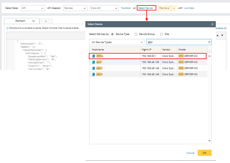

  1. Click Select Device, then select the device that the API parser applies to. Devices can be filtered by Device Type/Device Group/Site. You can search for the required device.

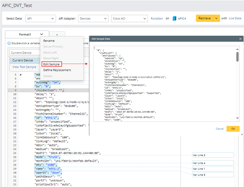

    Alternatively, you can also manually input the sample text or edit the retrieved sample text.
  1. Define line patterns for parsing variables (for the steps of defining the line pattern, refer to the steps in Define a Variable Parser/Define a Paragraph Parser/Define a Table Parser), then click Apply to apply the line patterns. You can check the parsed variable data in the Output pane.
