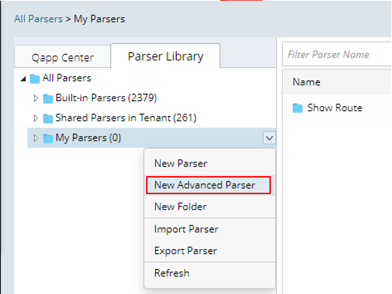

    1. To create a Parser, click the start menu  and select Parser Library.
    2. Right-click My Parsers and select New Advanced Parser.

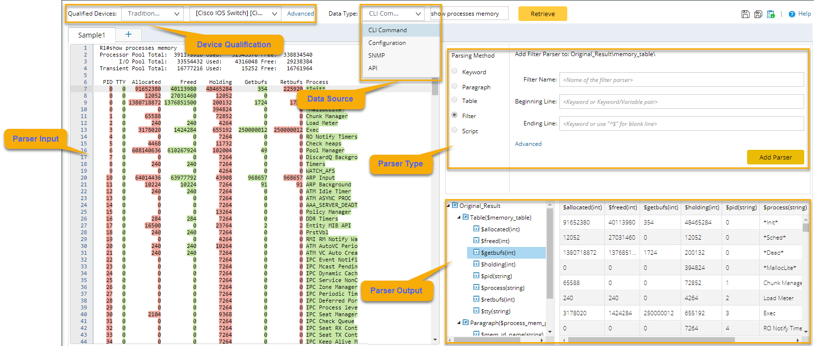

    3. Create the Parser:
      1. Define the device qualification.
      2. Define the data source, and the retrieved sample data will be displayed in the Parser Input area.
      3. Selecting a Parsing Method to define the Parser type.
      4. The Parser output is displayed.
