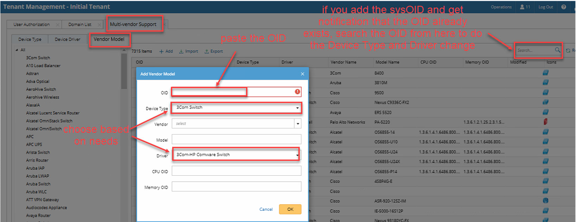

  1. Click Add. The Add Vendor Model dialog box prompts.
  2. Enter the required information, such as OID, device type, vendor, and model.
  3. Click OK.

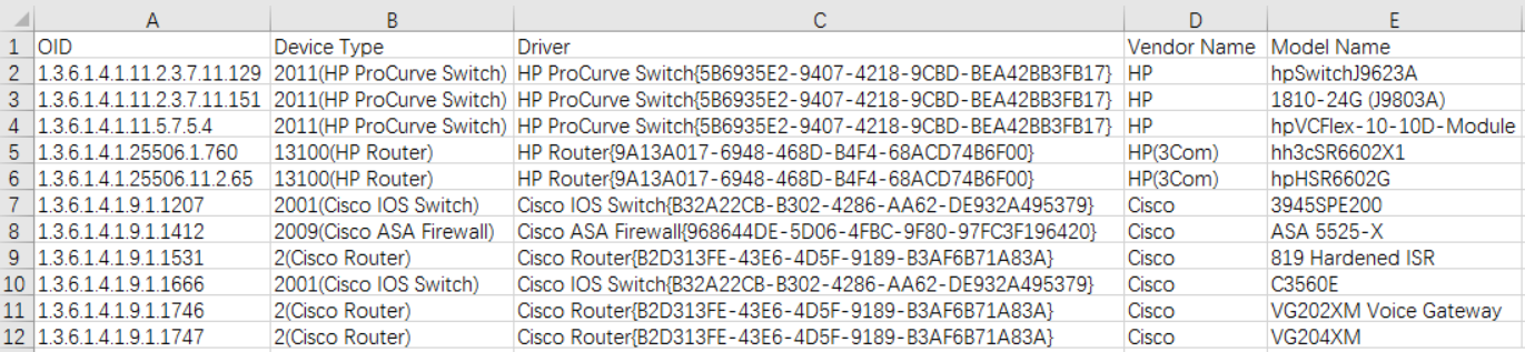

Importing a .csv file
  1. Create a .csv file in your local folder. For example:

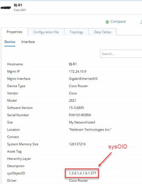

  1. Check the sysOID for the device in the Device Detail pane.

  4. Add the sysOID from step1 to the OID field in Add Vendor Model window and select the proper Device Type and Device Driver. Click OK. Graphical user interface, application
    Information Tip: If the sysOID already exists, search it from the search bar, then modify it.

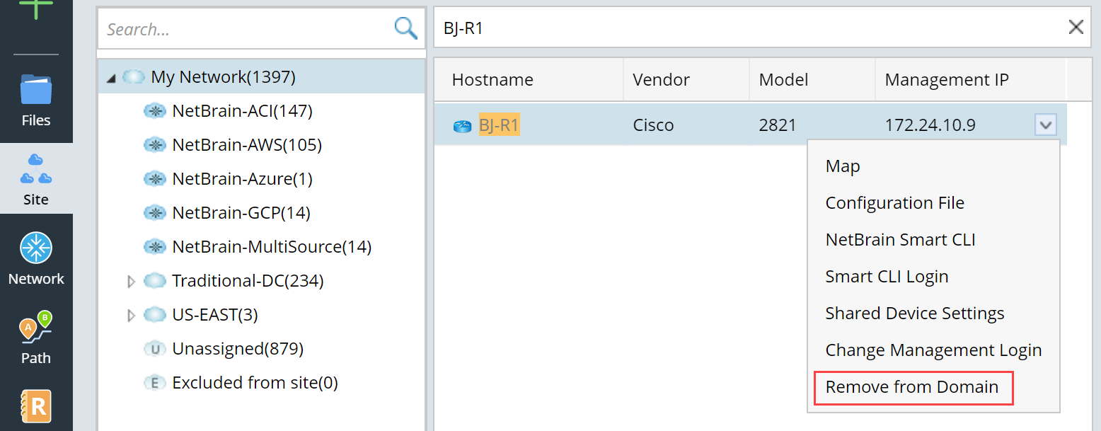

  5. Remove the target device from your domain if it was discovered with the unintended Driver.
