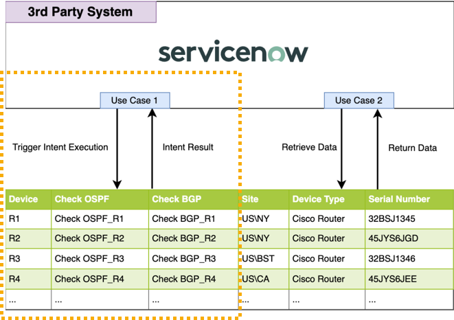

Use Case 1: Trigger ADT Intent and Get Results
Users can call APIs from the 3rd-party system to trigger a network intent, and get the task status; When the task is completed, send an API call to obtain the execution result.
3rd-Party API Call Trigger Intent Execution
An API call sent from the external system calls NetworkBrain TAF Lite to trigger the network intent(s) located in a specific ADT view and retrieve the execution result.

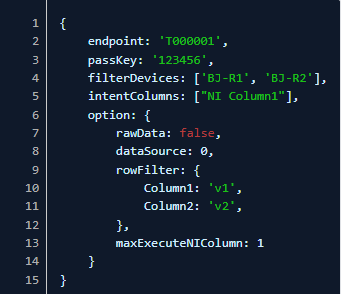

  • Output. taskId. The Id for this execution task.
Sample Input and Output:
Input
A screen shot of a computer program  Description automatically generated
Output
A screenshot of a computer program  Description automatically generated

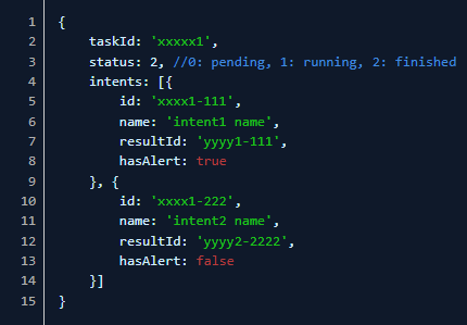

Call API to Obtain Task Results
Intent execution takes time to complete; therefore, the execution result might not be available immediately. When an intent is triggered, the API will return a task id and use it to query if the execution has been completed.
When the execution is ongoing, the API will obtain the task status periodically until the execution is finished. If the execution is completed, the API will return the ‘Finished’ status, along with the ResultID for the execution.
  • API URL: API/V3/TAF/Lite/result
  • Description: The API is for retrieving Trigger Intent List and Intent Execution Result Id.
  • Method: Post
  • Input Parameters:
    Parameter Type Required Description
    endpoint string Yes The endpoint generated by the system when users add an ADT view to TAF Lite.
    taskId string Yes This value is mandatory and can be found in the response from the API used to trigger intent.
  • Output:
    Field Value/Description
    taskId The task Id for the intent execution
    status
    The task status:
    • 0: Pending
    • 1: Running
    • 2: Finished
    intents
    (Filled when the status is ‘Finished’)
    The list of triggered network intents.
    intents[].id
    The intent Ids.
    intents[].name
    The intent names
    intents[].resultId
    The intent result Id
    intents[].hasAlert
    If there’s any alert status code in the NI execution result.
    • false: No alert.
    • true: There is at least one alert.
Input
Output
A computer screen shot of a code  Description automatically generated
