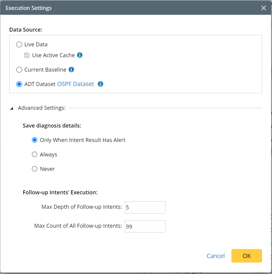

ADT Dataset can be used for intent execution, including the execution of follow-up intents. The execution settings for running follow-up intents are the same as the execution settings configured for the home intent. The features supporting using the dataset as the data source for intent execution are listed below:
  • Intent View Dialog
  • Intent Editor Dialog
  • Auto Intent
  • Quick Intent
  • Map Intent (Including running map intent by schedule)
  • Path Intent
  • Published Intent
  • Run Intents in ADT
  • Trigger to run intents via Timer in PAF
  • Run member intents in batch via NIC
  • Run NIC/NI/ADT/Follow-up triggered diagnosis in TAF
You can define the execution settings for running intents via the features listed above in the following common dialog (Except the “Run member intents in batch via NIC” and “Run NIC/NI/ADT/Follow-up triggered diagnosis in TAF” features).

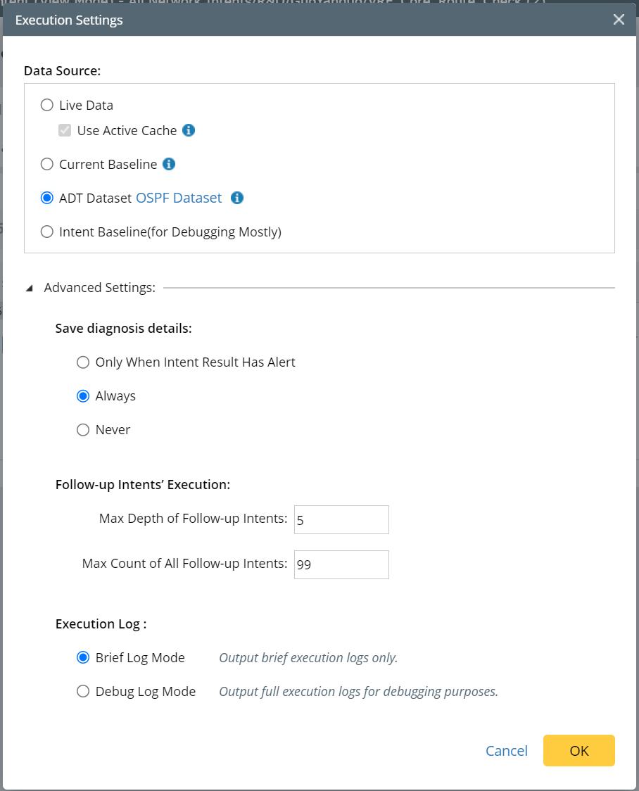

The Execution Settings dialog for running member intents in batch via NIC is shown below:
 A screenshot of a computerDescription automatically generated

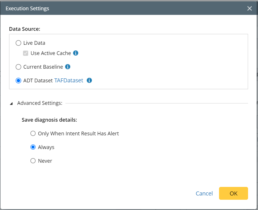

The Execution Settings dialog for running triggered diagnosis in TAF is shown below:
Information Note: For running triggered diagnosis in TAF, you cannot configure the execution log mode. The brief log is used by default.
