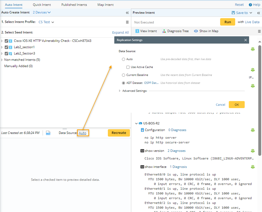

1Auto Intent
  • Use the ADT dataset for intent replication via Auto Intent.
  • Use the ADT dataset for intent replication via Auto Intent when it is called from Path Browser.

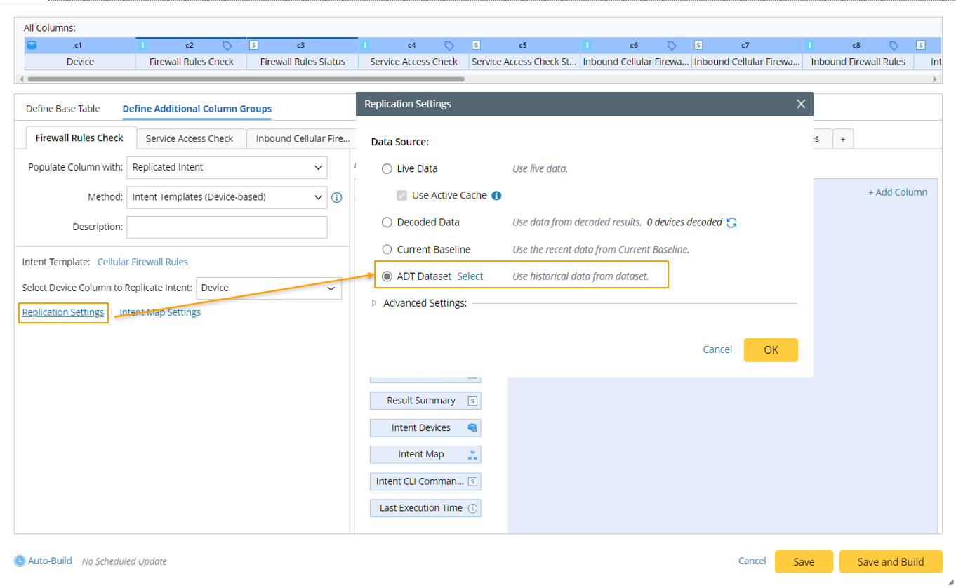

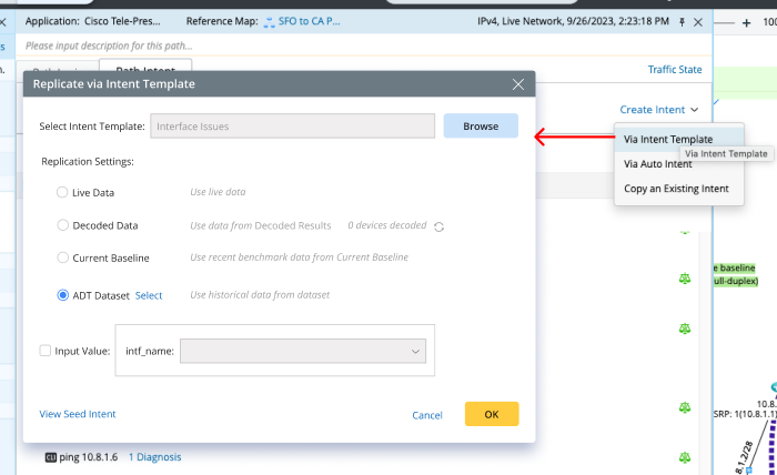

3ADT - Intent Template
  • When the intent template is used as the data source for creating a column group, the dataset can be selected in the replication settings.

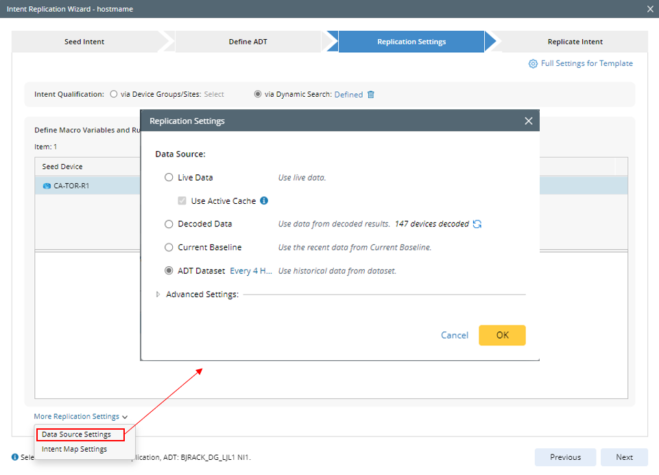

4ADT – Intent Replication Wizard
  • ADT dataset, config files from the current baseline and current baseline can be used for intent replication When the intent is set for device-based replication or path-based replication in Intent Replication Wizard.

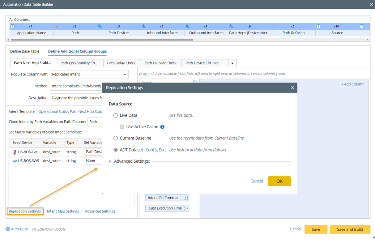

5ADT - Intent Replication for Path
  • When Intent Replication for Path is the method for building a column group, the ADT dataset can be used in Replication Settings.

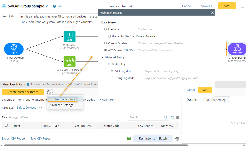

6NIC - Create Member Intents
  • Use the ADT dataset for generating member intents via NIC.

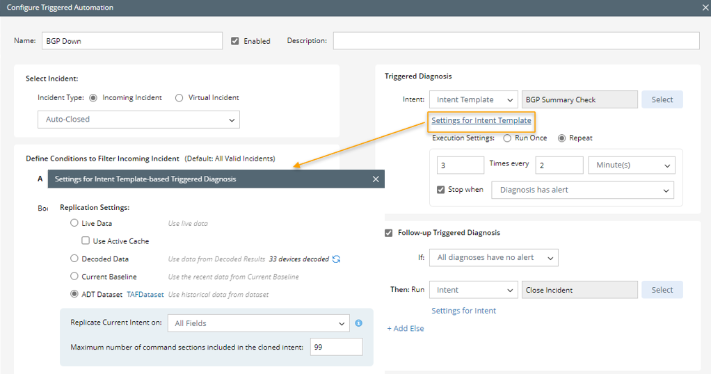

7TAF – NIT-based Triggered Diagnosis
  • ADT dataset can be used for intent replication in NIT-based triggered diagnosis.
