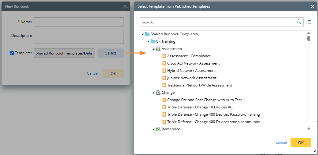

Three ways of the device qualifications defined in the template will be automatically applied to refine target devices on the current map:
  • When you create a runbook on a map by applying a runbook template:
