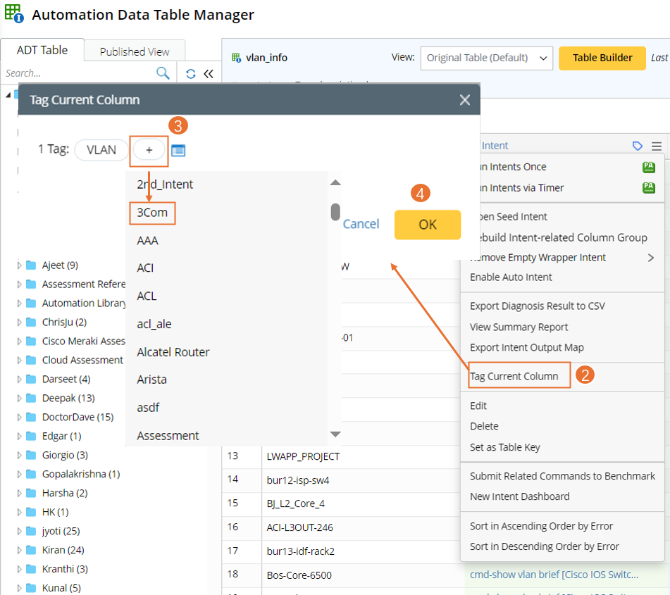

Open the Tag Current Column dialog from the drop-down menu of the target automation column, then enter the tags.
- Open the target ADT in ADT Manager.
From the drop-down column of the automation column, select Tag Current Column.
In the pop-up dialog, click the

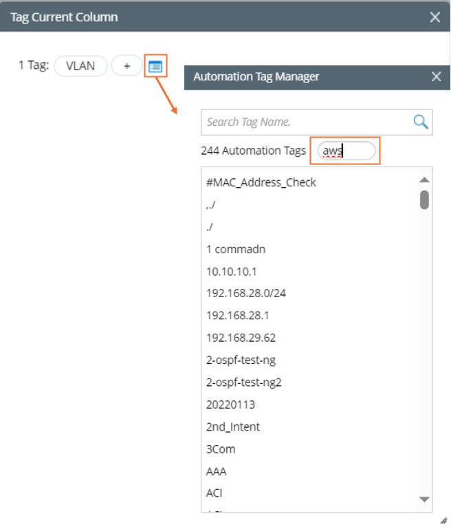

icon to select tags (for example, tag "3Com") from the drop-down list.- If you need a new tag, click the
icon in the Tag Current Column window, then click +Add Tag to add a new tag.
- Click OK to add the tags.

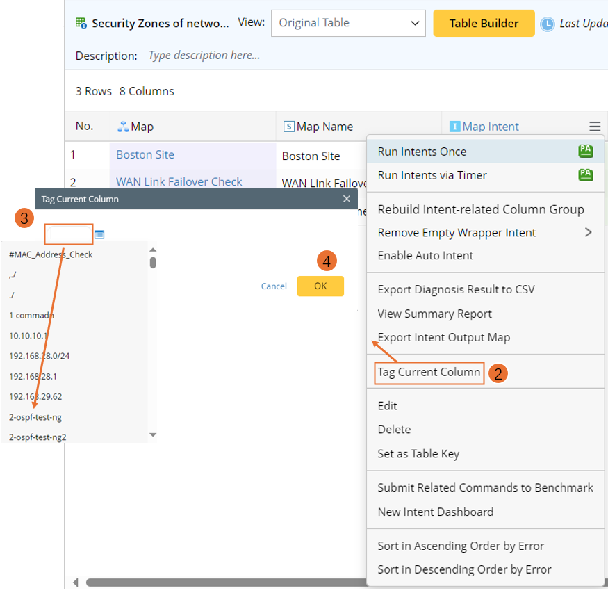

Tag Current Column dialog from the drop-down menu of the target map column or map automation column, then enter the tags.
In the pop-up dialog, click +Add to select tags from the drop-down list.

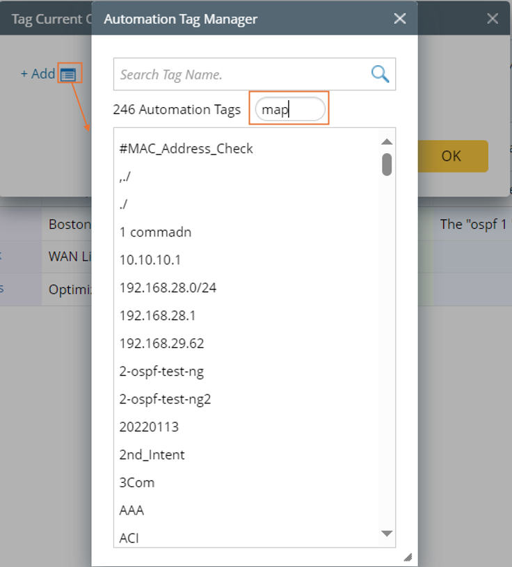

- If you need to use a new tag that is not included in the tag list, you can add a new tag to the Automation Tag Manager: click the
icon, then click +Add Tag in the pop-up Automation Tag Manager window. Input the tag.
