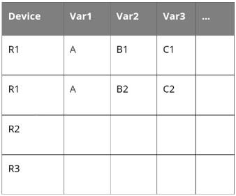

When users build ADT to do intent-based network assessment, there is a high-frequency table structure as shown below.
Device “R1” has more than one row in ADT with different parameters. To build this ADT, users have to use NIC with signature variables, but it is complex to be maintained and used by users and NetBrain engineers.
