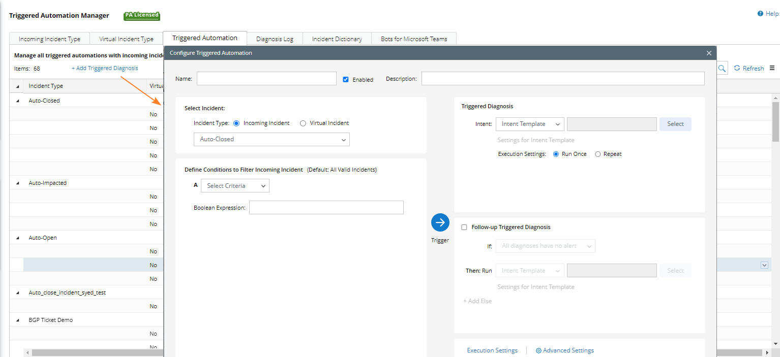

  • Use Triggered Automation to trigger NI:

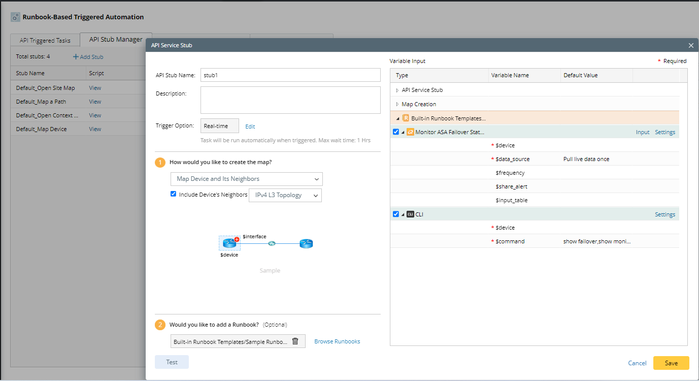

  • Use API Stub to trigger NI.
    The typical use case is that the 3rd-party system will trigger NetworkBrain Runbook Template execution, including an NI node. For example, a ticket is created since a BGP neighbor of a core device is flapping, which triggers an API call to the NetworkBrain System, and the device name and BGP are sent to NetworkBrain as a keyword. A NetworkBrain Runbook can filter NIs related to this device and BGP and execute these NIs.

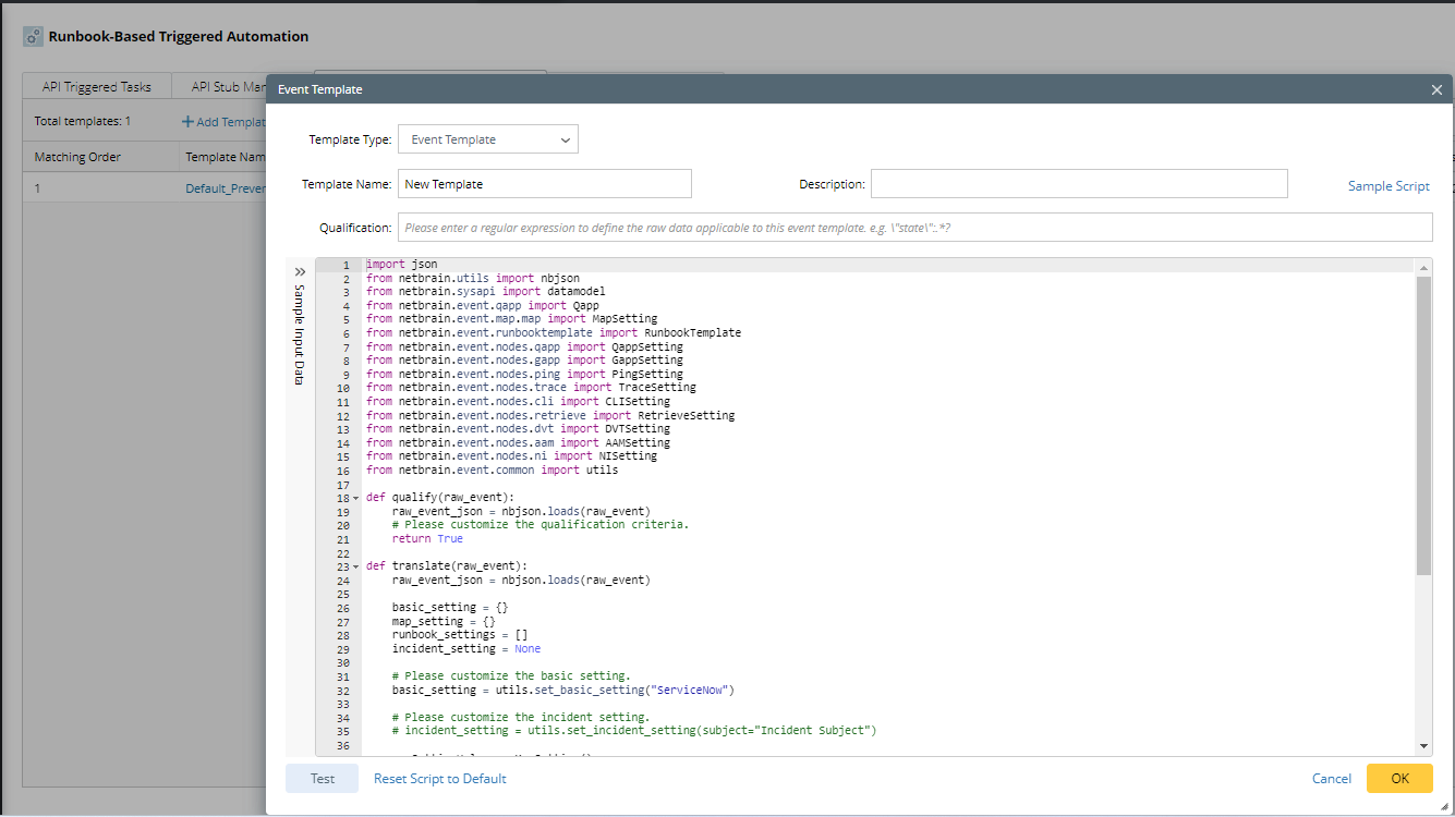

  • Use Event Template to trigger NI:

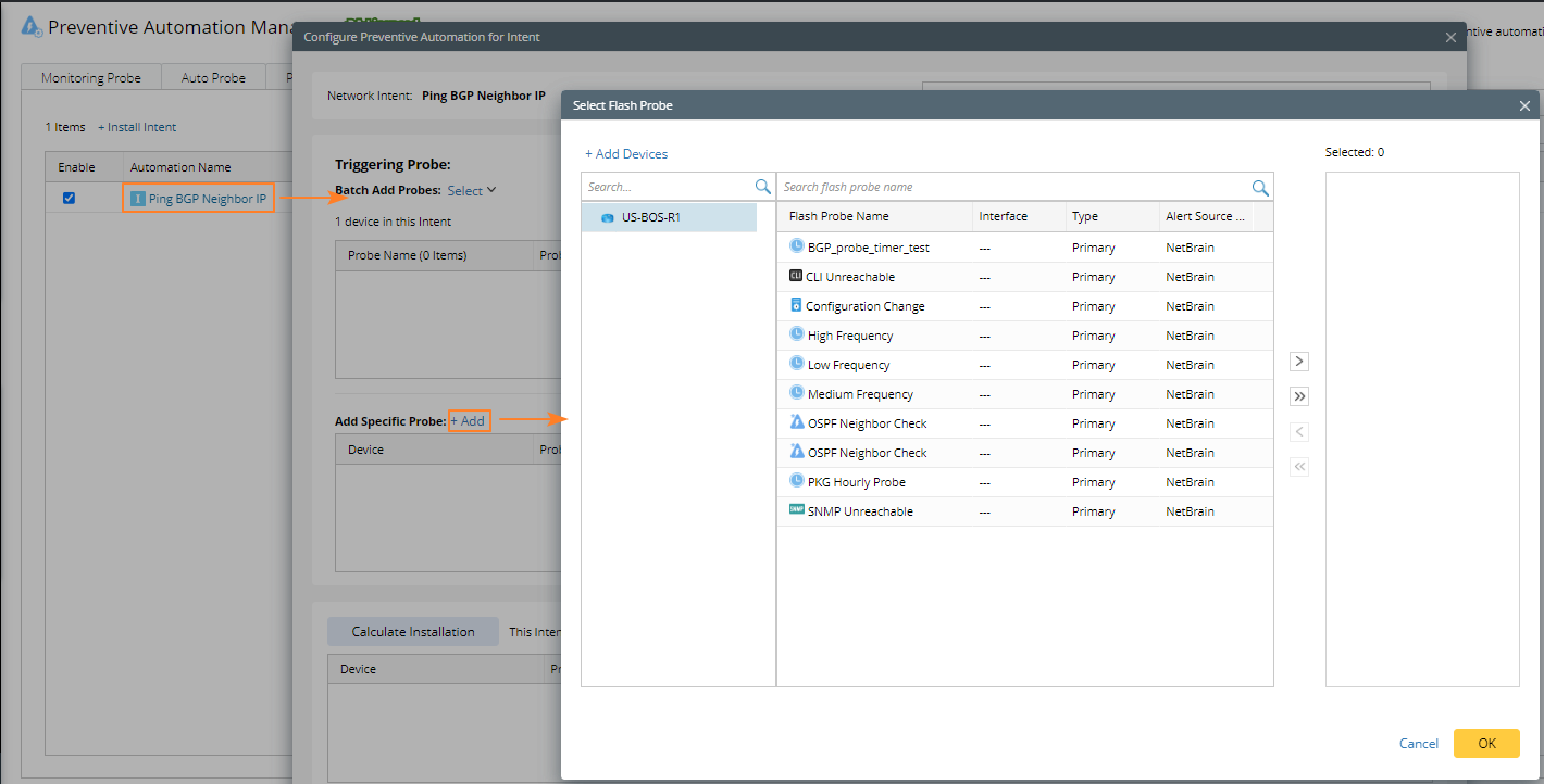

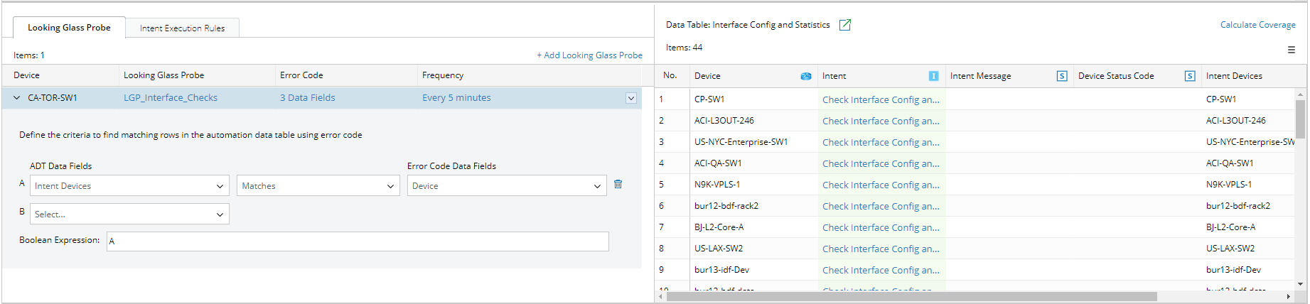

  • Looking Glass Probe:
  • Primary Probe:

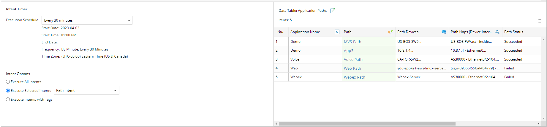

  • Intent Timer:
Schedule Intent Directly
Intent can also be scheduled to run at backend automatically.
