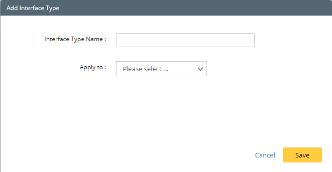

  2. On the Tenant Management page, click  and select GDR Data Configuration from the drop-down list.
  3. On the Interface Properties tab, right-click the root node, and select Add Interface Type from the drop-down menu.
  4. Configure the interface type on the right side.
  • Interface Type Name — the name of the interface type. It must be unique to identify the interface type.
  • Apply to — the device types that the interface type will be applied to.
  1. Click Save. The new Interface Type will be added.

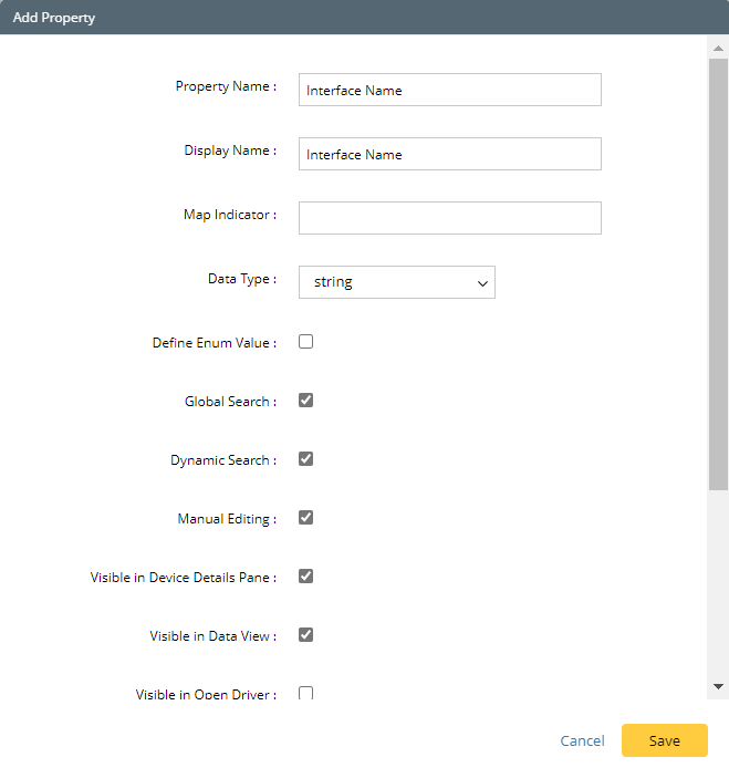

  2. Right-click the new interface type node, then select Add Property.
  3. In the pop-up Add Property dialog, specify the attributes of the interface type.
  4. Click Save to close the Add Property dialog. Now the new interface type is defined and can be applied.
