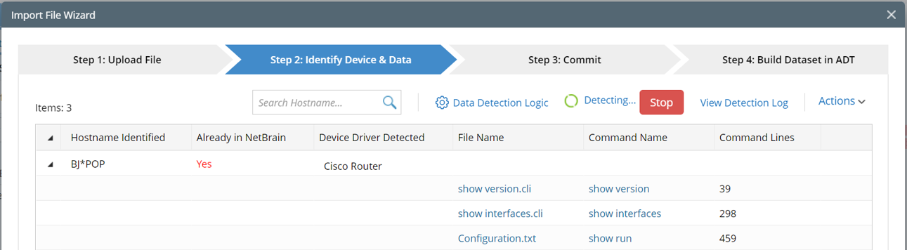

  • You are allowed to manually stop the detection during the process.
  • You can also view the detection log as follows. More logs such as invalid regex expression and regex matching timeout can also be included.

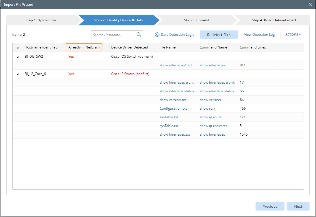

The Already in NetworkBrain column indicates whether the device with the same hostname already exists in the domain.

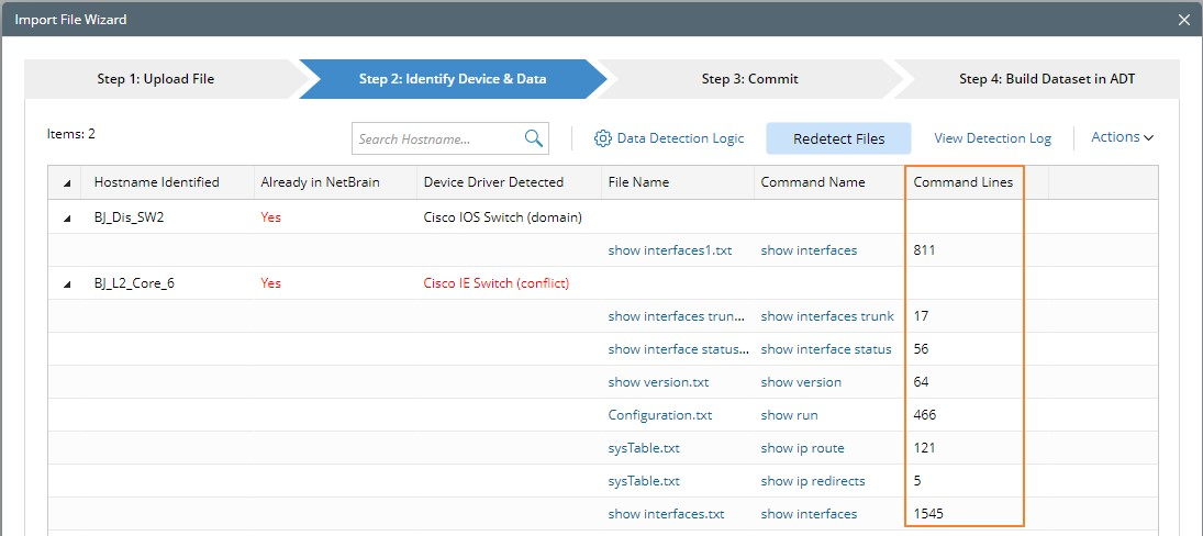

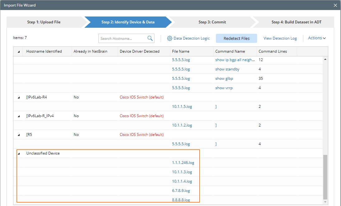

  • Files from which device hostname and command cannot be identified are categorized into the Unclassified Device group.
  • Clicking a command can view its details to check whether a command text is identified correctly – correct start and end line.
  • The Command Lines column shows how many lines the command result has, which helps check whether the command texts are detected correctly quickly.
