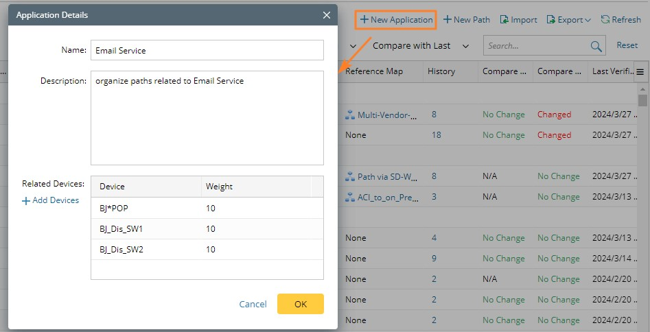

  1. Click the start menu   and then select Application Manager.
  2. Click New Application at the upper-right corner and define the details as follows:
    1. Enter a meaningful name for the application, such as Email Service.
    2. (Optional) Add a description of the application.
    3. (Optional) Add related devices to the application and define a weight for each device.
      Information Tip: Each related device has a default weight value of 10, and you can double-click to modify the value. The weight is used to sort the application list order. See Application Weight for details.
    4. Click OK.
    5. Repeat to add more applications.

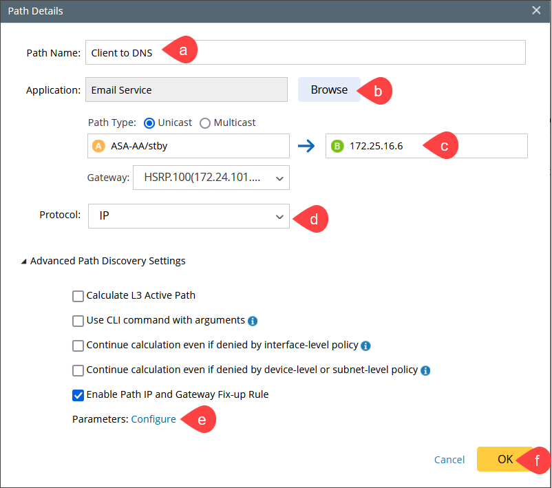

  3. Click + New Path at the upper-right corner of the Application Manager pane and define the details as follows:
    1. Enter a meaningful name for the path, such as Client to DNS.
    2. Select an application for the path, such as Email Service.
    3. Specify the parameters to calculate the path.
      • For the unicast path, enter the source and destination.
      • For the multicast path, enter the multicast receiver, source, and group value.
    4. Specify an application protocol for the path. By default, the protocol is IPv4.
    5. (Optional) Click Configure to input QoS parameters if the source device is an end system with QoS configured. See Parameters for details.
    6. Click OK.
    7. Repeat to add more paths to the application, such as Client to SMTP and POP3 to Client.

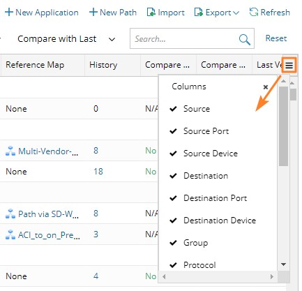

Customize Table Headers in Application Manager
The Application Manager displays all the information about paths by default. To remove specific table headers, click the icon and uncheck them.
