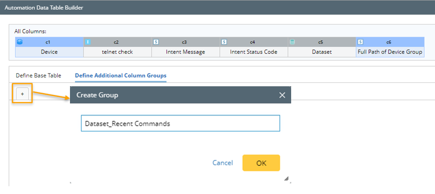

- Go to Automation Data Table Builder, create a Base table, then create a new group and name it (for example, "Dataset_Recent Commands").
Note: It is recommended the Base Table contains device column that is used for creating Dataset column later. - Under the new group tab, define the following basic settings:
