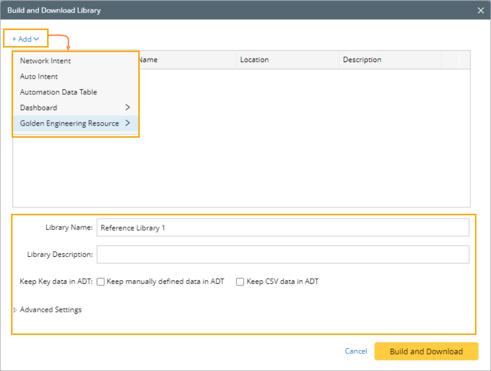

  1. In the Build and Download Library dialog, Click + Add menu to access the resources to build the library:
Select the following resources to build the library:
  • Network Intent
  • Auto Intent
  • Automation Data Table
  • Dashboard
  • Golden Engineering Resource

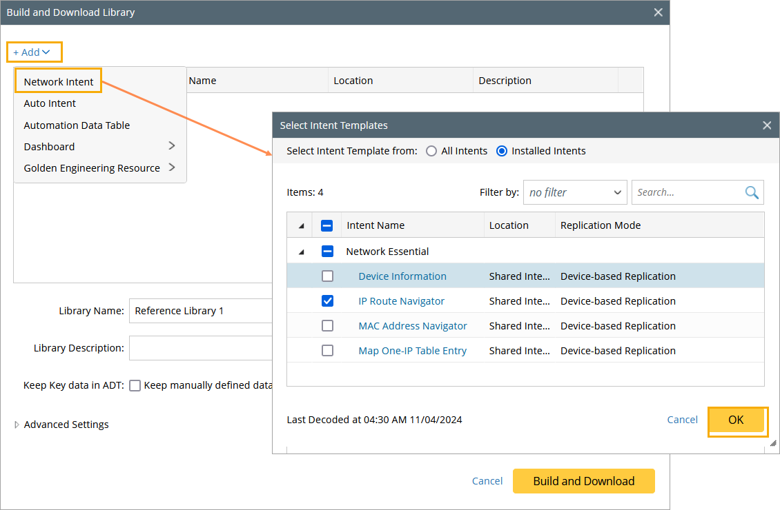

Network Intent
  • Click + Network Intent to add intent template resource, then check the checkbox to select intent templates.
  • Click OK to finish the selections and close this window.
    In the Filter by field, click , then select Device-based or Path-based as filter (intent templates are divided into two types "device-based" and "path-based" based on replication mode) to narrow down the scope of intent templates displayed.
    After selecting the intent template:
  • For installed NITs: “copy intent” script and “install intent” script will be automatically created.
  • For NITs that are not installed: Only “copy intent” script will be created.

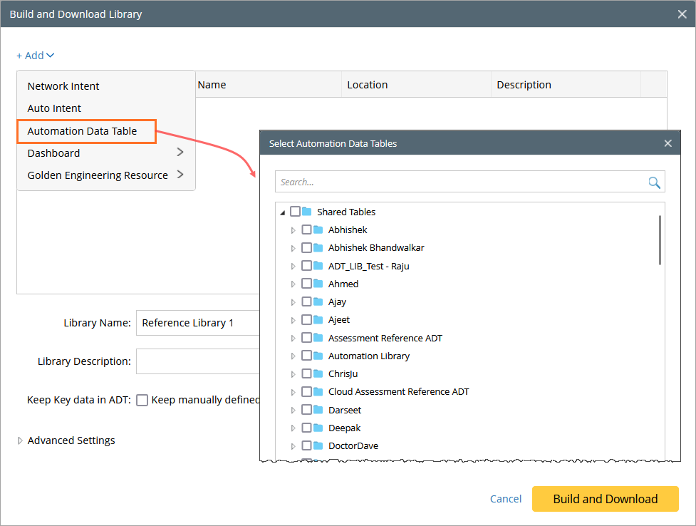

  • Click + Automation Data Table to select ADT, then check the checkbox to select ADT.
  • Click OK to finish the selections and close this window. For more information about ADT definition, see Automation Data Table (ADT)
    Information Note: ADT is the carrier of Dataset. When the ADT to be exported contains Dataset, the dataset data will be treated based on certain rules and logic. For more information, see ADT Dataset.

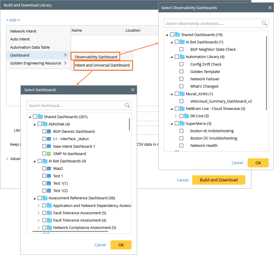

        Dashboard
Observability Dashboard is designed to centrally check alerts/success information for a batch of dashboards.
  • From the + Dashboard dropdown, select Observability Dashboard. The "Select Observability Dashboard" dialog lists all the Observability dashboards in the domain. Observability dashboard is designed to centrally check alerts/success information for a batch of dashboards.
Information Note: Another option of the + Dashboard (Intent and Universal Dashboard) is used to select Intent Dashboard and Standard Dashboard.

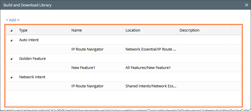

You can select all the required resources by following and repeating the above steps. The selected resources will be categorized and displayed in the table node structure in the Build and Download library dialog.

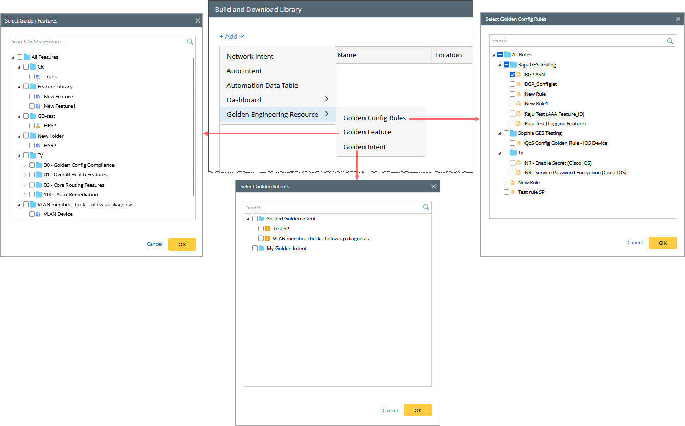

The NetBrain download includes the following resources for Golden Engineering: Golden Config Rules, Golden Feature, and Golden Intent.
To build the library, follow these steps:
  • From the Golden Engineering Resource menu, select each of the following submenus one-by-one: Golden Config Rules, Golden Feature, and Golden Intent.
  • For each option, a selection window will appear, allowing you to choose the appropriate option.
Information Note: For selected Auto Intnet, ADT, Dashboard, and Golden Engineering Resource, the asset configuration files and correspond YAML script are generated.
  1. Define the basic information of the new library.
  • Library Name: Input the library name. The default setting is “Reference Library1”. You can change the name.
  • Description: Input description for the library to indicate its use, function, etc.
  1. Define advanced settings: Click next to Advance Settings to expand the Advance Settings block, then define the basic information for task. By default, the library contains one task and the basic information of the task can be defined here.
  • Folder Name: Input folder name. The default folder name is “Folder1”. You can change the folder name.
  • Task Name: Input task name. The default setting is “Copy and Install resource”. You can change the task name.
  • Task Description: Input description for the task to indicate the resources in the task, goal of task, etc.

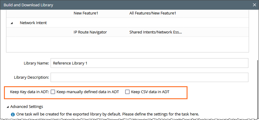

  1. Keep Key data in ADT: These functions are designed to manage manually defined data and CSV data in ADT when it is used as a source for building the Library. When these functions are enabled, both manually defined and CSV data will be exported to the Library.
    For example, Golden Config Templates in ADT will be exported as resource in Library when the Keep manually defined data in ADT checkbox is selected. In addition, the intents in the manually defined intent column will also be exported to the Library as related resources.
    Information Note: By default, the Keep Kay data data in ADT checkboxes are not selected. You can select them based on your requirement.

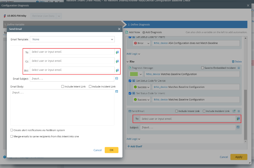

    Clean Information in Exported Library
    When the library is exported, sensitive personal information and some configuration information will be cleared. The flowing table describes the removed information.
    Feature Sub-feature Description
    Intent Send intent diagnosis via email User email information in intent diagnosis, e.g., information about email receivers is removed.
    Dashboard Send Dashboard Alert via email
    • User email information in dashboard alert notification is removed.
    • Disable the Alert Notification in Dashboard Alert notification.
    Lock Lock NIC, NI, and ADT Lock settings defined for NIC, NI, and ADT are removed during exporting/importing.
