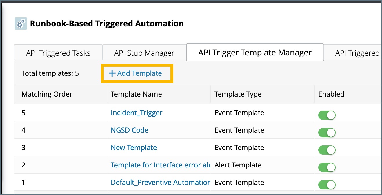

  1. Go to Runbook-Based Triggered Automation > API Trigger Template Manager, then Click Add Template

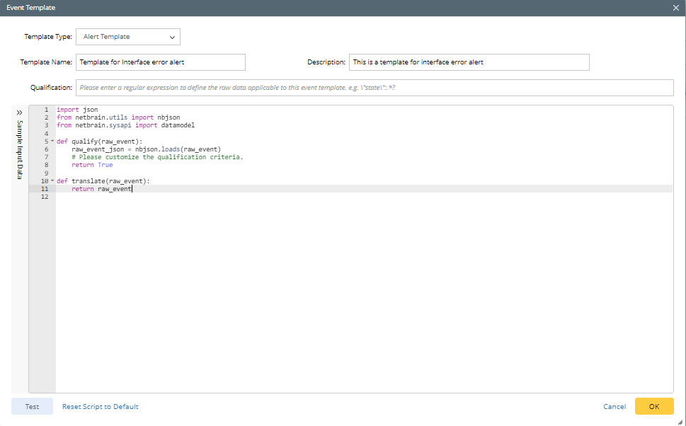

  2. In the pop-up dialog, define an alert template:
    1. Select Alert Template for Template Type.
    2. Enter the Template Name and Description.
    3. In the Qualification field, enter a regular expression to define the applicable row data.
    4. Define the JSON Script.
  3. Click OK to finish the settings.
  4. View the alert template. The created alert template will be listed under the API Trigger Template Manager tab. The created alert template is enabled by default. You can disable it by turning off the Enabled function.
