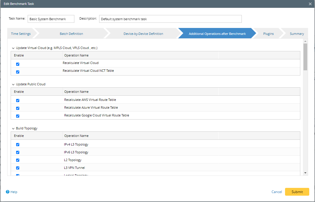

Additional Operations after Benchmark
There are many additional operations to be executed in Benchmark after the data retrieval to build topology and update system data:
  • Update MPLS Cloud
  • Update Public Cloud
  • Build Topology
  • System Operations
  • Rebuild Visual Space
  • Update Maps
  • Auto Set Golden Path
  • Application Verification
  • Run Scheduled Tasks after Benchmark
  • Email Alerts
Recommended Settings
  1. Update MPLS Cloud: Select both options Recalculate Cloud and Recalculate Cloud NCT for Basic System Benchmark if there is MPLS Cloud in your network. Sometimes large MPLS Cloud takes a long time to rebuild, and you can create an individual Benchmark task with less frequency to rebuild them. See <hyperlink to Best Practice> for details
  2. Update Public Cloud: Select all Virtual Route Tables for Public Cloud vendors you have in your network.
  3. Build Topology: Select all the options under Build Topology to keep the topology accurate. If it takes a long time to rebuild the L2 topology, you can create an individual Benchmark task with less frequency to rebuild them. See <hyperlink to Best Practice> for details.
  4. System Operations: Select all the options for the basic System Benchmark.
  5. Rebuild Visual Space: Select all the visual space templates for the SDN vendors in your domain.
  6. Update Maps: Enable Update Site Maps to keep site maps updated. You can select Yes under Export to Visio to back up the map files in Visio Format.
  7. Auto Set Golden Path:  Enable Auto Set Golden Path when there are many application paths in the domain, and it is hard to manually define the Golden Paths for them.
  8. Application Verification: Enable Application Verification by checking the Enable box. Click on +Add Application and Path to add the applications and paths for verification.
  9. Run Scheduled Tasks after Benchmark: Click on + Scheduled Data View Template/Parser Task and select built-in task to update the Built-in Data View Templates and Parsers after Benchmark.
  10. Email Alerts (Optional): Enable Email Alerts by checking the Enable box. Select the conditions to send the Email when task execution fails, or configuration file retrieval fails. Attach the execution log and live access log with failures in email.
