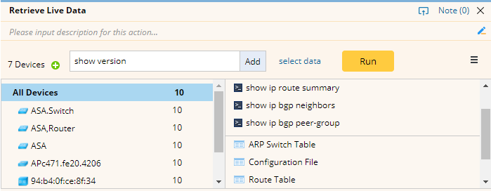

  1. On a map, select Retrieve Live Data from the right-click menu. The Runbook pane is opened with the Retrieve Live Data action node added.
    Information Tip: If a runbook has already been opened, the Retrieve Live Data node will be added to the current Runbook; otherwise, it will be added to the personal Runbook.
  2. Select the target devices. By default, this action applies to all existing devices on the map. To customize target devices, click the icon.
  3. Enter the CLI command and click Add repeatedly to add multiple CLI commands. By default, all the commands in the list will be executed for all target devices. To add a CLI command for a specific device, select the device in the device list, enter the command, and click Add.
    Information Tip: To add commands using CLI templates, click the  icon and select Load CLI Templates. You can also create your own template. See CLI Template for more details.
  1. Click Select data to add more data types.
    Information Tip: To save the retrieved data as the latest copy for future analysis and comparison, select the Auto update all selected data in Current Baseline check box.

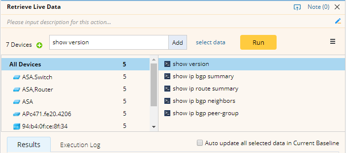

  2. Review the selected commands and click Run.
  1. After the execution is finished, select a specific CLI command to view its output, or click the Execution Log tab to view the execution log.
    Information Tip: To save an action node and its input for reuse, point to it and click the  icon to select Save as Favorite.
