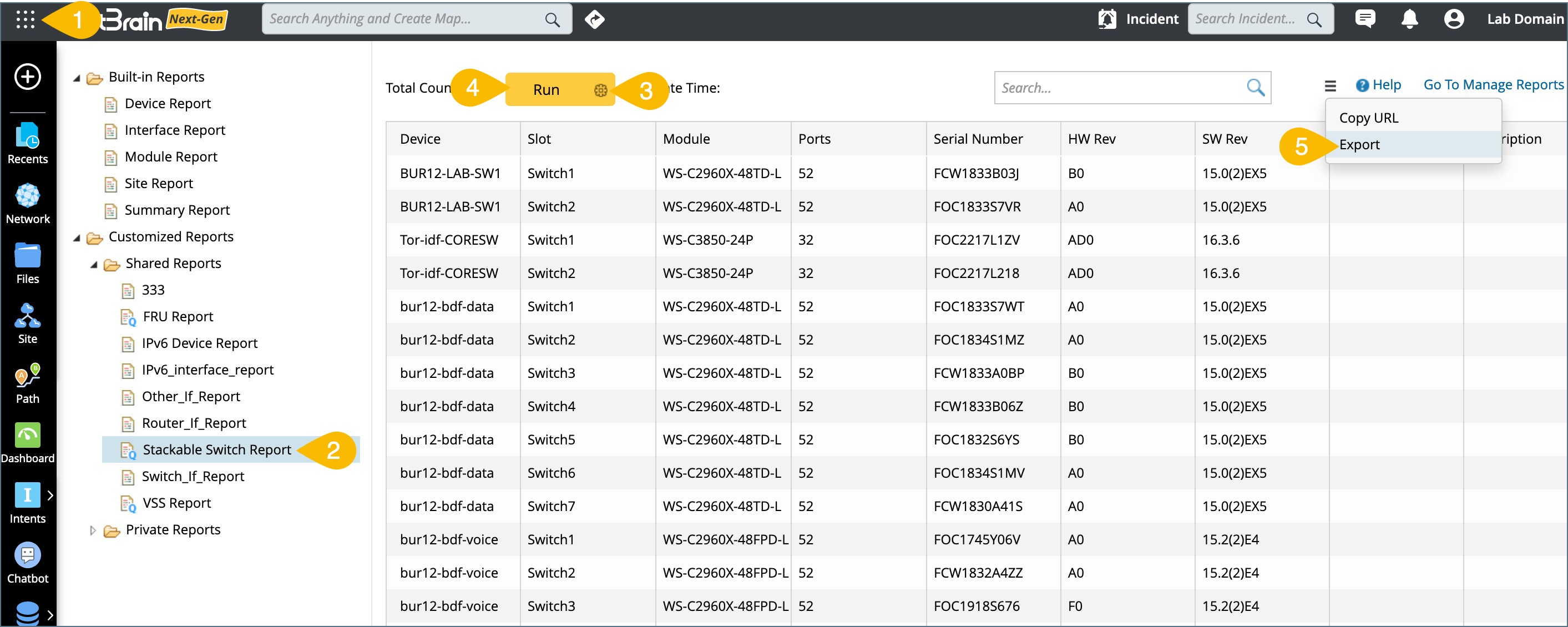

Export a Qapp Report
  1. Click the start menu  and select Inventory Report.
  2. In the left pane, select a Qapp report. The report data is displayed with the data generated last time.
  3. For the predefined Qapp report, the data source is the live network by default. To change the data source, click the icon.
  4. Click Run to retrieve data for the Qapp report with the specified data source.
  5. Click  and choose Export.
    Information Tip: The default location of the exported file is C:\Users\<your username>\Downloads. If the outputs of the selected Qapp contain several CSV reports, you can only select one sheet to export.

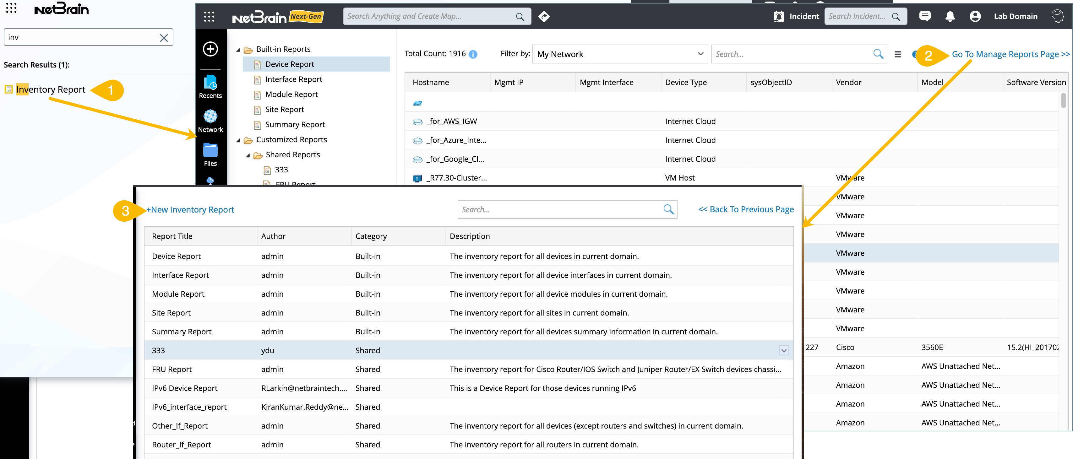

  2. Click Go to Manage Reports Page at the upper-right corner.
  3. Click New Inventory Report on the new page. A wizard will prompt to guide you through the steps to create a report.
  4. Enter the report name and description, and then click Next.

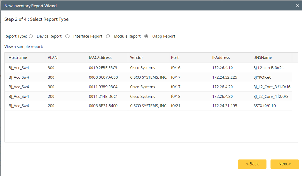

    2. Select Qapp Report as the report type, and the corresponding sample of a Qapp report will be displayed for reference. Click Next.

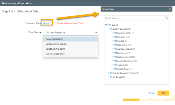

    3. For the Qapp report, you need to select a Qapp with report output and specify the data source. Click Next.
